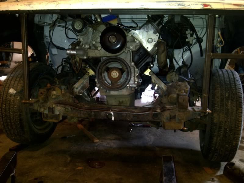

did you make the motor mounts?

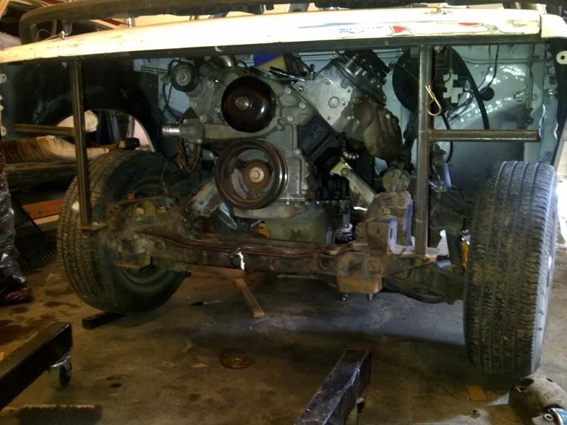

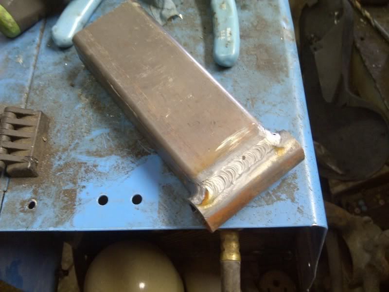

Thats awsome do you have any pics of your motor mounts, or suggestions for the swap?? I am right in the middle of doing a 350 swap right now. Any advise and tips would be greatly appreciated.
dr.dub
dont have any pics of the mounts i thought i had some on my phone. it's just solid moroso mounts on homemade ls adaptor plates. then i took some 1x2 steel and welded a tube on one end and then hung them off the mounts with the motor sitting in the bay. cut trim some grinding and welded then 1x2 directly to the frame. it's a tight fit on the drivers header but we have about 8 solid days of work into it. video of it driving wont be till mid sept. as i'm out of town for 5wks working. although we did drive it around. the neighbours kinda got pissed as we had no plates or windshield in it at this point... but it was fun as hell.

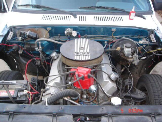

dr.dub
this was the old 350 setup

sorry i lied they were already downloaded to my computer...
canucksfan1
Thanks for the pics, what did u do for a computer?? Or with the carb and MSD and valvetrain, does it not need one?
