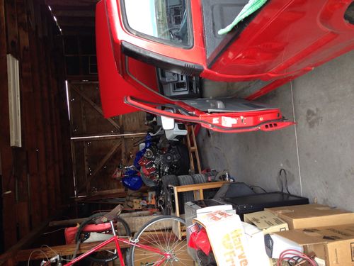

95 through 02 ARE fe3. Just with different intake and exhaust manifold. Check out my pics. I have a 01 Fe-dohc from a 2wd sportage.
