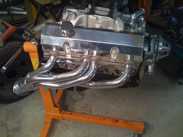

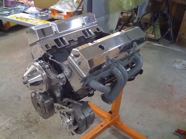

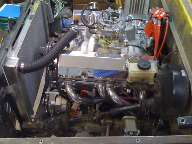

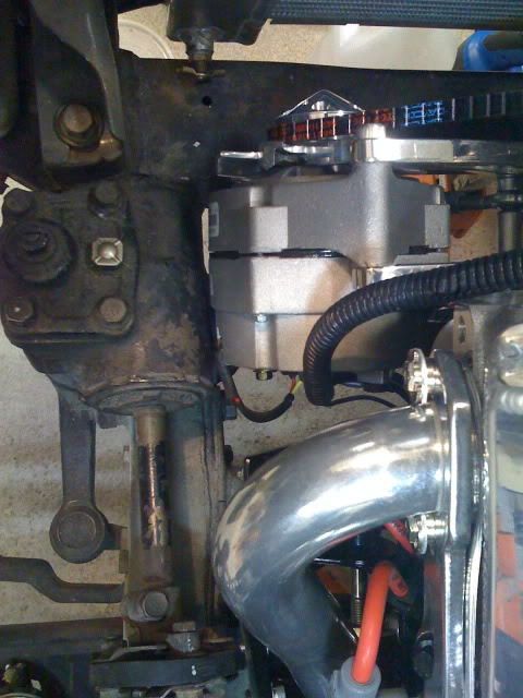

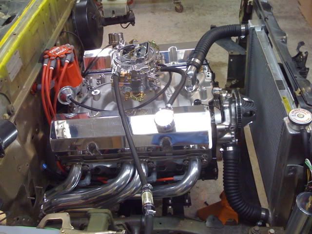

oo7bob
no clue as to how these mid length would work on a bd truck, i had to create a little space in the pass floor, and both were heated and bent in to get off the frame rail
block huggers like these exit right above the cross member but leave enough room to turn under

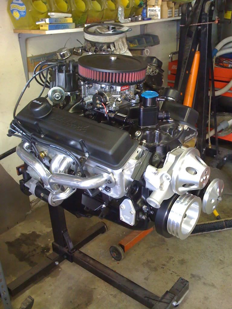

Heres a pic of the Sanderson Tight Tuck headers I was gonna run on the truck I was building. They were going to fit great with the setup I was doing.
