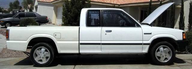

Well, I'm brand new to this forum and I thought I'd share a few modifications to my 2600i. It isn't as polished as some of the pretty trucks on this site, but it is mine!

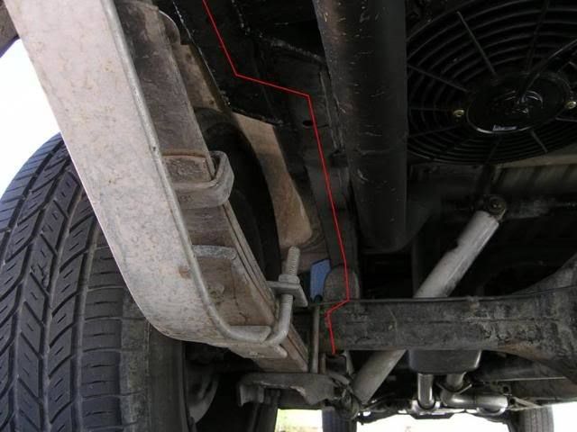

Before swapping the motor, I lengthened the wheelbase, because I never liked the rear wheel well location on the Cab Plus truck beds. It always looked funny to me.
So I actually used the complete back two thirds of a second truck frame to accommodate the standard bed.
At some point, I'll lower it an inch or two, but it'll never be slammed. This one is getting set up to do some road racing!
Then, I narrowed the frame section at the rear wheels, so I could stuff some fatties in there... someday. I'll need to fabricate a ladder bar suspension and do some wheel well work to make it happen.

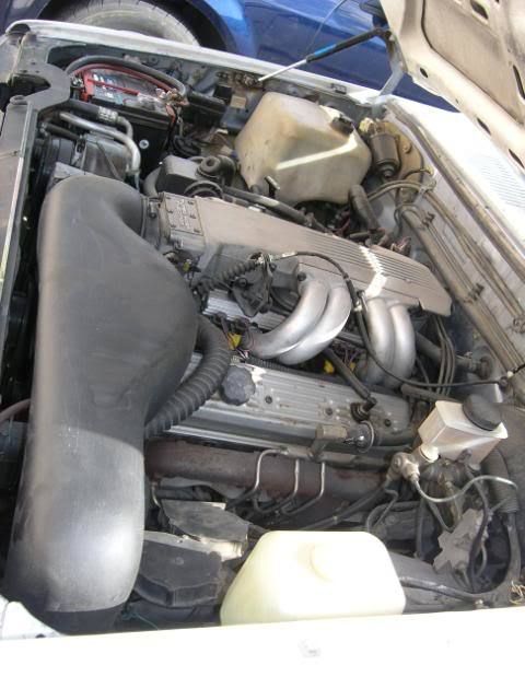

So, on to the engine... TPI 5.7 liter w/700R4 Transmission
In preparation, I had to notch the crossmember to set the engine in a bit lower. I did this so I wouldn't have to modify the firewall or the transmission tunnel.
The black intake tube is hand made from fiberglass and is wide in the center because it gets pretty thin going over the alternator.

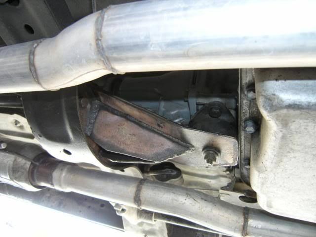

Building the motor mounts was a piece of cake.

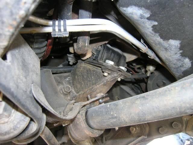

In the first pic, you can see the 1-1/8 inch sway bar that I modified from a Formula Firebird(which donated all the GM parts I used).
...and this is a 50 state emissions legal install. All GM smog equipment was transferred over too.

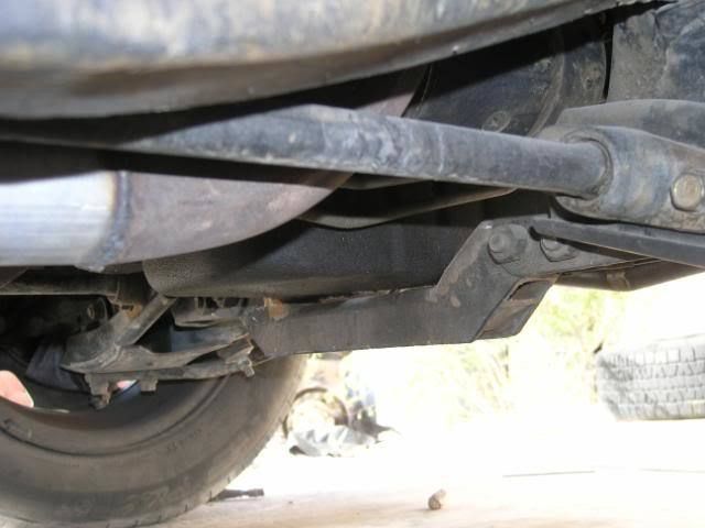

I had to toss the Mazda Transmission crossmember and make my own mount that is through bolted to the torsion crossmember.

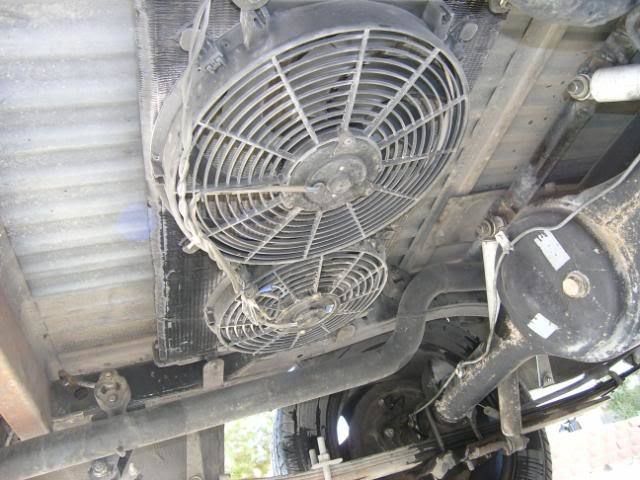

For those of you who noticed an AC compressor in the first engine pic...
Yes it is equipped with a fully functioning system(I live in Las Vegas). I just had to move the condenser under the bed!

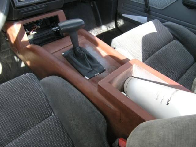

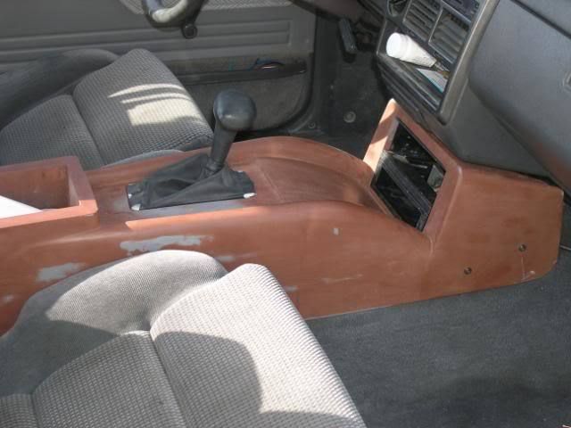

I mounted some Prelude seats in the cab, but nobody sees them with the hand made fiberglass console(not finished yet).

i love that console. nice, slick, but stockish looking. does your nose bleed alot? welcome to the site man.

I pissed off my wife while I made the console! It took up a lot of time, but I wanted it to look like it belonged there.

just looked back over the pics i noticed you had gas shocks for the hood... do they hold the hood up as well without needing the hood prop?
sincitylocal's avatar
sincitylocal
They hold the hood up fine, because its really light, but I have to change their position.
It's tough trying to find the right geometry.
