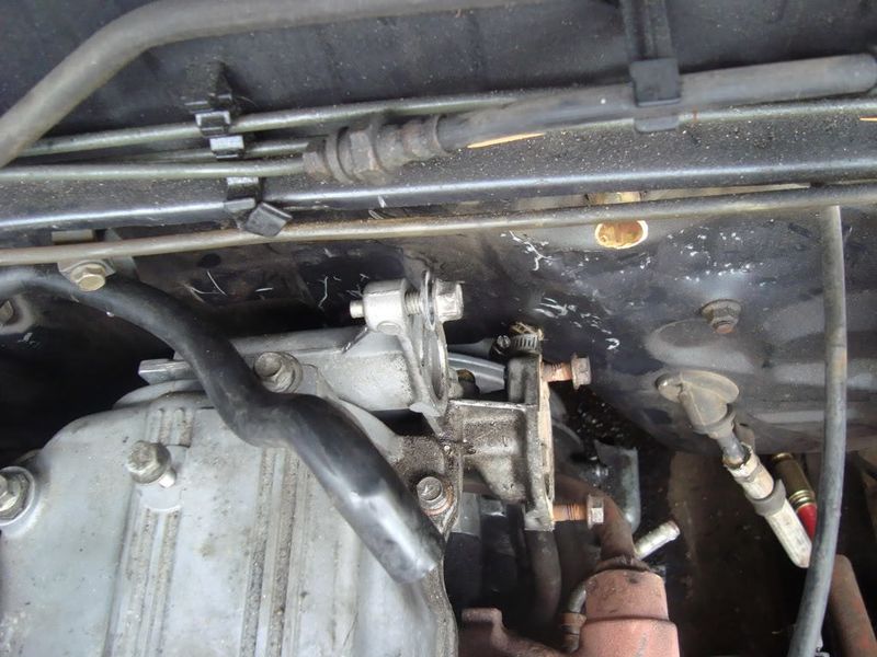

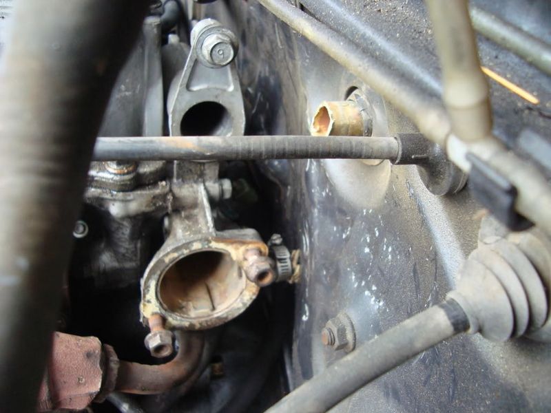

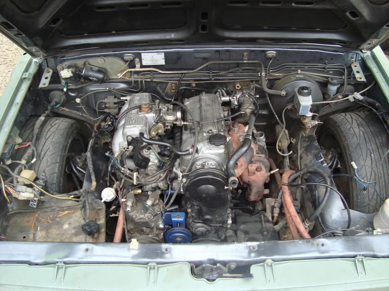

thoutght id throw up a pic of this very engine going in going to raise the trans a inch lower the moter 3/4 inch and push the whole thing forward 1" , also rotating the dizzy 1/4 turn will give me the clearance i need . will also let me plug in the coolant temp senser on the back of the water neck, also before you put it in change the pan to a standerd on off youre truck motor and the pick up so you can clear the crossmember hope this helps will start a thread when i do it all to help others out

will post pics toomorow just got done puting my motor back in it was a breeze i moved the whole motor and trnas foe=rward a 1-1/2" and vwollaw it fits
