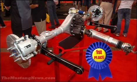

buy a shortened mustang racing rear 9 inch with disc conversion already done, maybe chrome??
