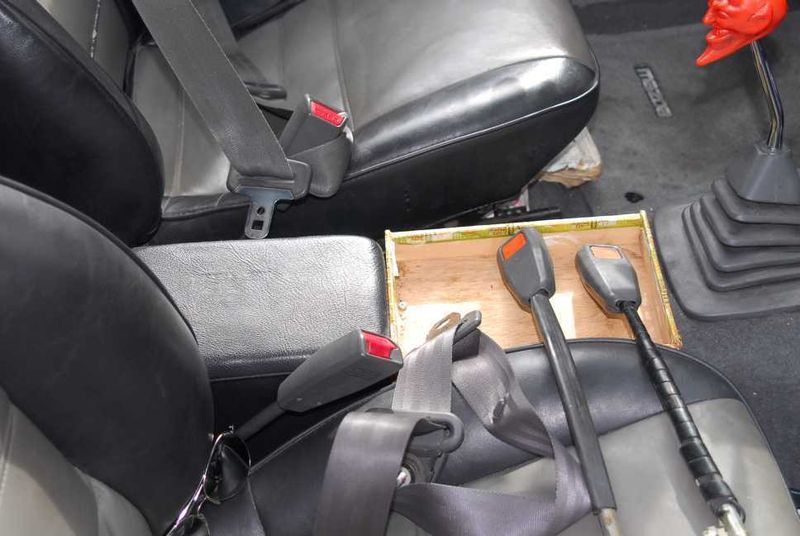

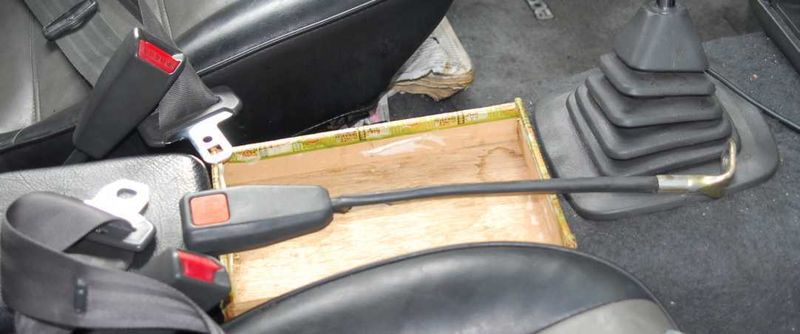

I had posted, with some photos, on "another board", photos of at least three types of seat belt buckles I've seen on B-trucks:
Think this is from a 1992 Cab Plus front
This is from a 1992 Cab Plus rear (my 1988 Cab Plus has only lap belts in the rear)

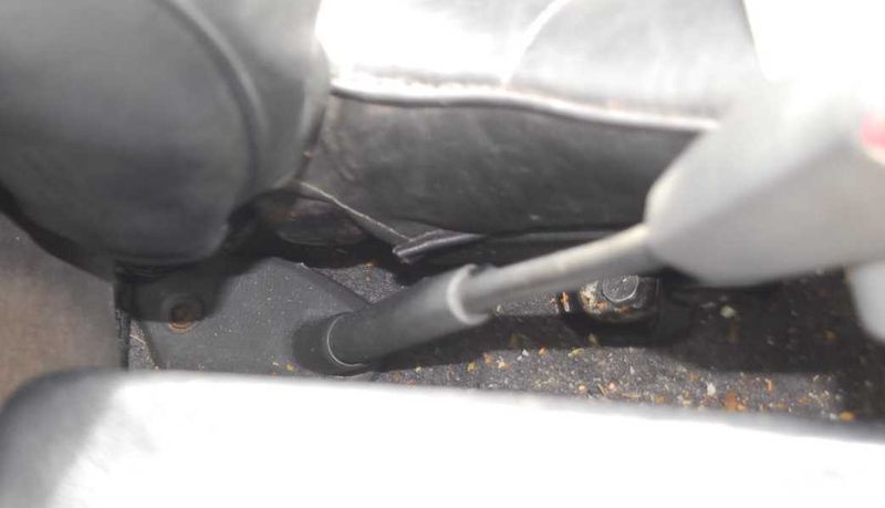

My original release, buttons were on the side. The "new" buckles have the button on top. I'll post pics in a day or so.
ulrich's avatar
ulrich
SE5 belts installed in base model.
You can see the plain bolt ends on the base/bench belts, Vs the plastic covered bold ends on the SE5/bucket belts.
Note: black electrical spiral wrap used to replace damaged cover, on original belt. Quick, cheap, easy.
