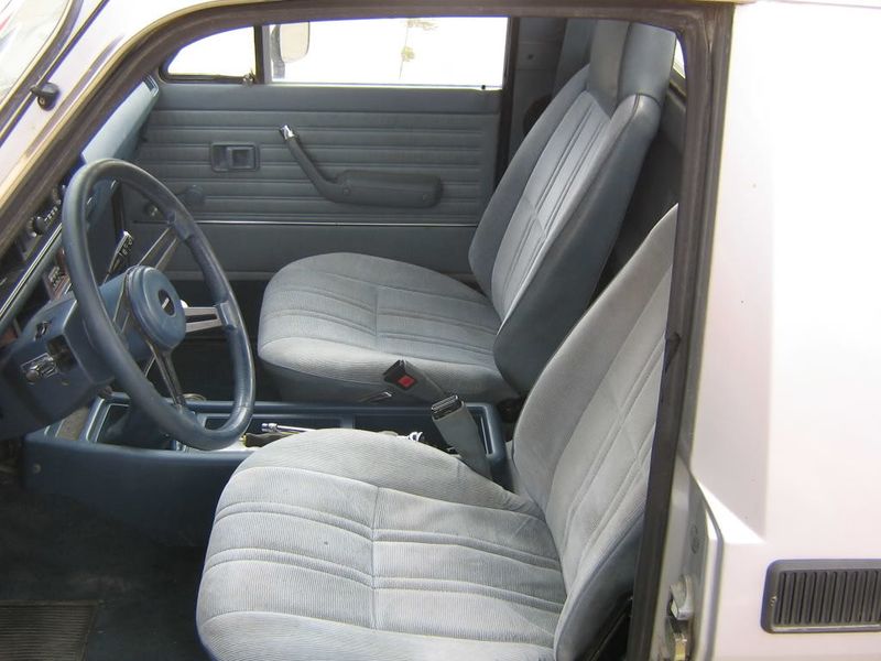

Here's my buckets. Look how freakin clean that interior is!

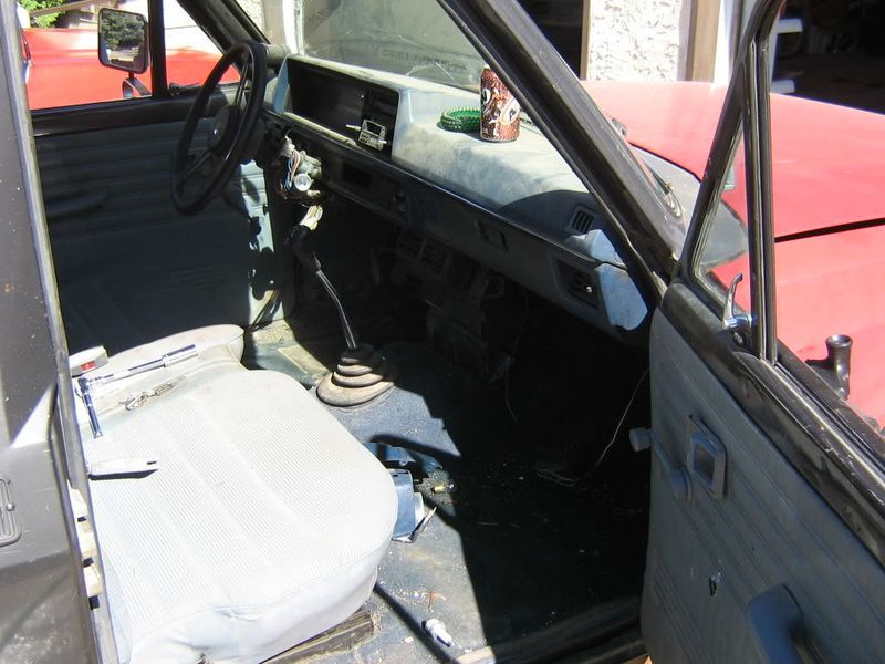

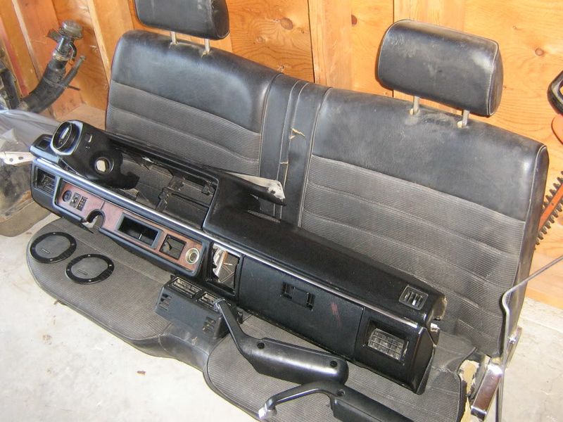

This is the black bench I'm putting into my red project truck

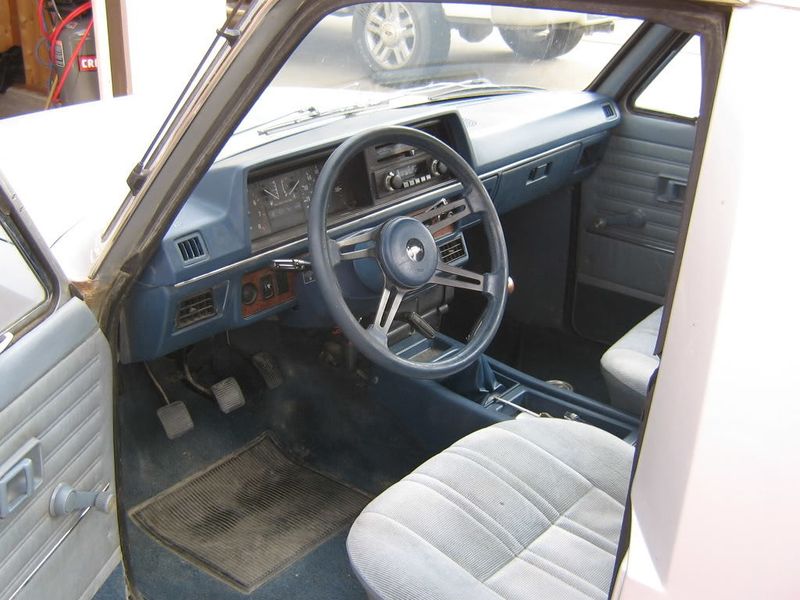

And this is the blue bench I want to put in the silver daily
