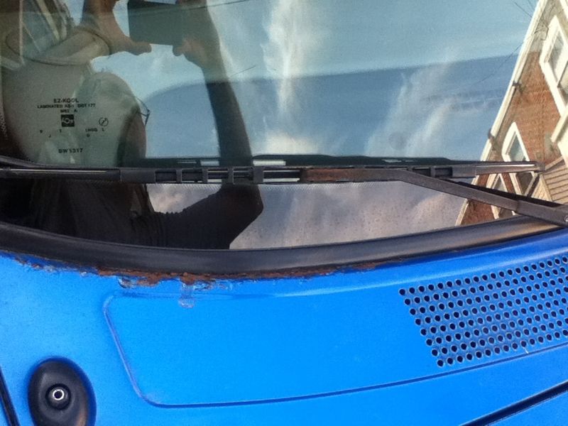

I have this really bad rust by my front windshield resulting in water seepage.
How would I tackle something like this?
Would any kind of rust neutralizer work well in this situation or should I be grinding it down?
Disposing of the cracked windshield is no problem.

If the windscreen is already cracked then I say bin it and get rid of that rust... which is tedious and tricky
Rust is not your friend.
Just gave a friend to do some on his van, luckily I have some suction cups so it made the windscreen easier to handle.
Sounds like a nice "how to" is in order, it may help motivate you during the process and we'd love to see it too.

You always want to cut out and replace rust whenever possible.
