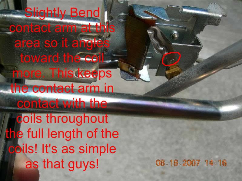

I've done a bit of looking around on here and i'm not 100% sure if the fix to it is removing the sending unit and bending it or not. Reason being most cases I've read the gauge wasn't working at all Does this sound like the right path to go?
Anyways when i fill my truck up it reads between 3/4's and full (I thought maybe the pump just kicked out early) and having a 14gal tank i usually put in 10-11 gallons of gas and it stops again. So i know it wasn't empty when it read so....
sincitylocal's avatar
sincitylocal
Yep, you need to bend the contact arm.
It'll fix you right up!

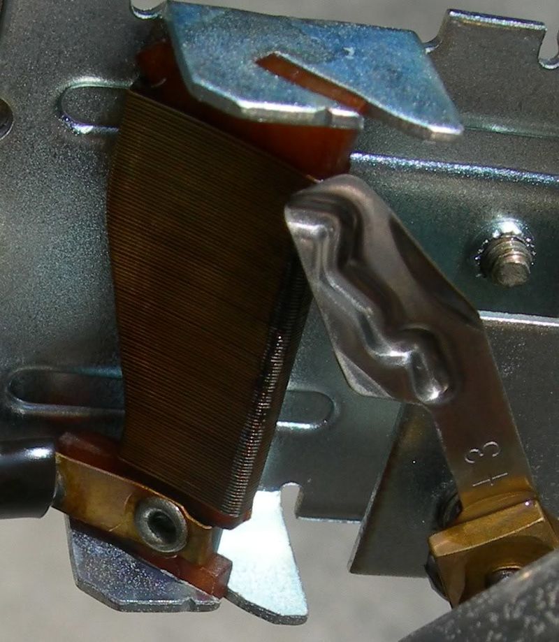

+1 on the contact arm.
Here is a close up of it also.
