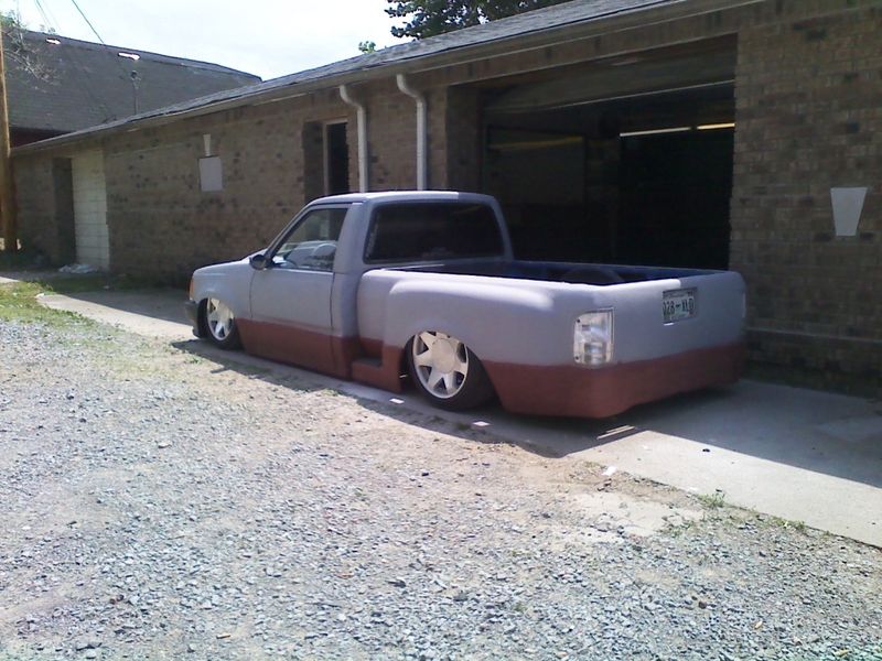

This is Mazdaman's truck before the wreck.The bed may look different than you are use to because of the shaved upper body line. It really changes the look of the bed a lot. The stock bed is fiberglass with a metal inner shell in case you needed to know. The bed sides actually bolt onto it. If you have ever seen a Flareside/Splash Ranger and noticed the black plastic strip on top with plastic caps every few inches, these cover the star bolts.

hey thanks baha..lol.. ya the splash/stepside bed is the one used most..mine as said has shaved body line and rised fenders to lay on 20s and the step was redone to fit the mazda cab shape, plus i cut and narrowed the bed 2 1/2" to fit better as it is wider the the mazda's

man that step side looks good!
