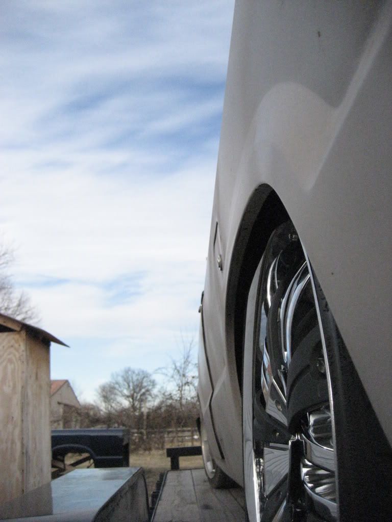

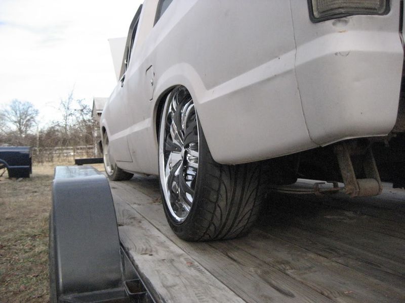

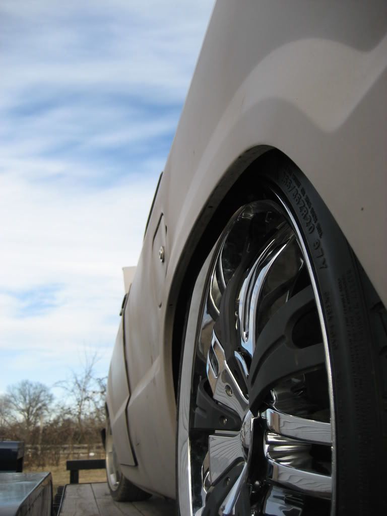

I have 20x8.5 silverado SS wheels with a 22mm offset, in the rear they tuck with 1/8 clearance to the unrolled fender lip. my front is modded, so the set-up in the front probably doesn't apply.

your wheels will be at least 1/4 to 3/8 farther out than mine, and mine are super close. you would definately have to flatten the lips completely, and have a watts link. I wouldn't go with those wheels.

the wheels are super clear all the way up. the only thing even close is the lip. i'm on 225/35 20s.
