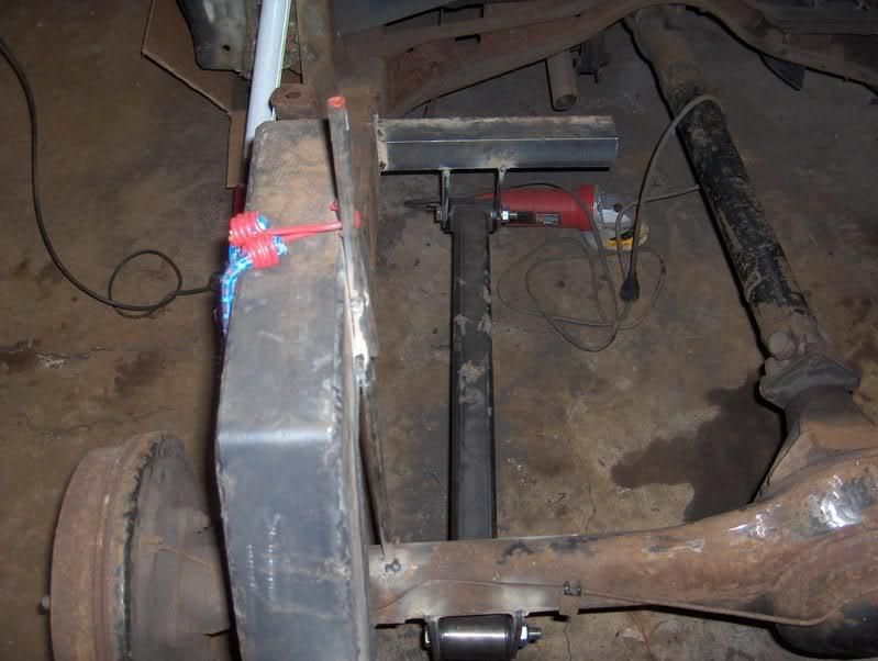

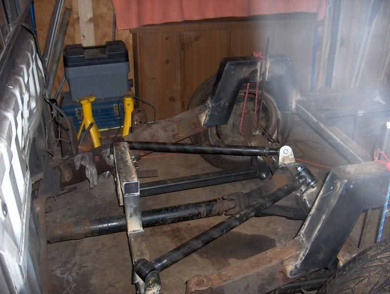

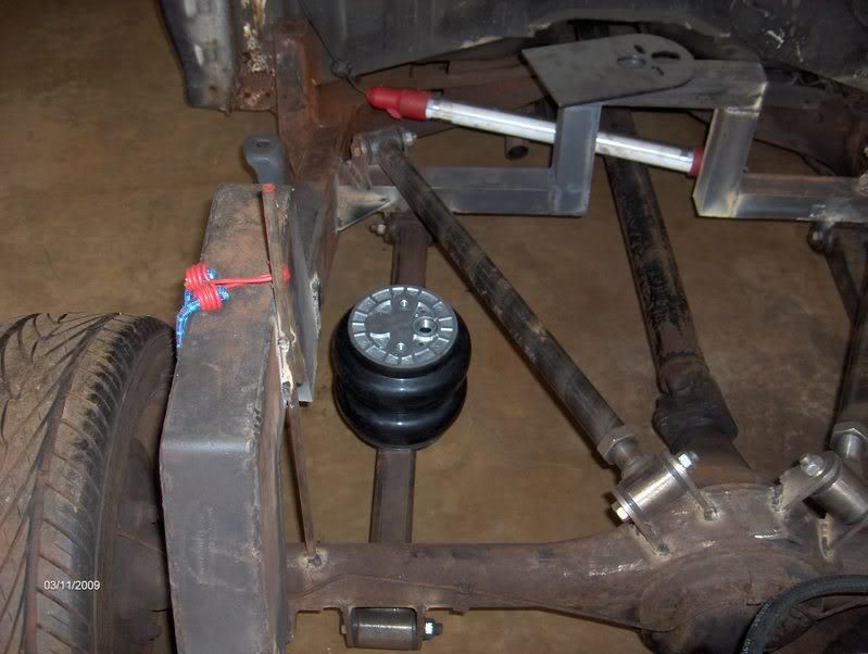

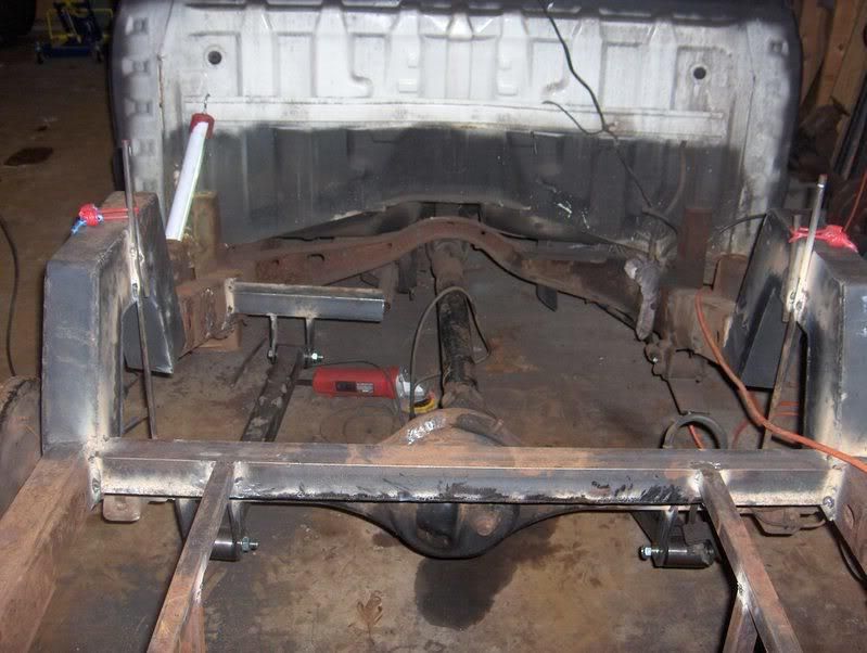

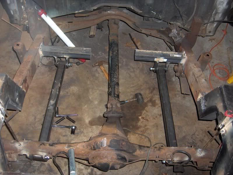

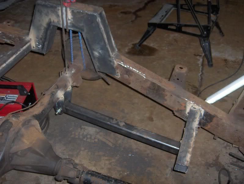

So finally i should get some pics up tonight. So far i have the notches done. and am currently working on the 4-link. I have a question tho. My bottom bars aren't completly paralell to the frame rails. is this ok. So far i have the drivers side done and i was going to do the passagener side to matchh. It's on a very tiny angle going in towards the driveshaft. This angle is facing the direction of the cab. pics up later. any advice on this whole bottom bars thing is appreciated.
E
maztang (ryan)'s avatar
maztang (ryan)
can't wait to see the pics man. the bars don't have to be paralell just need to make sure the pinion angle is correct.

How do I set pinion angle my friend???

check this out for you pinion angle man.
hope this helps.

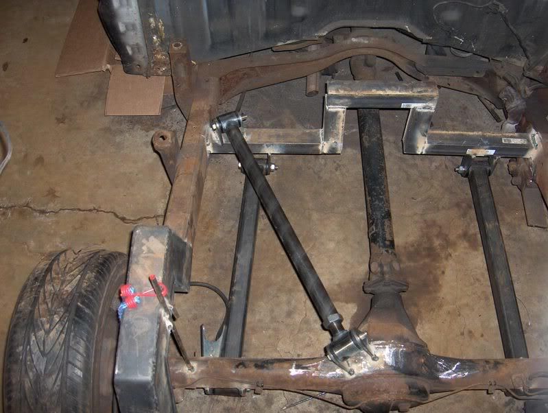

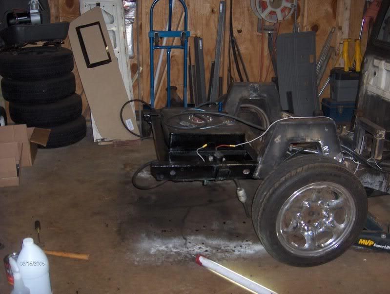

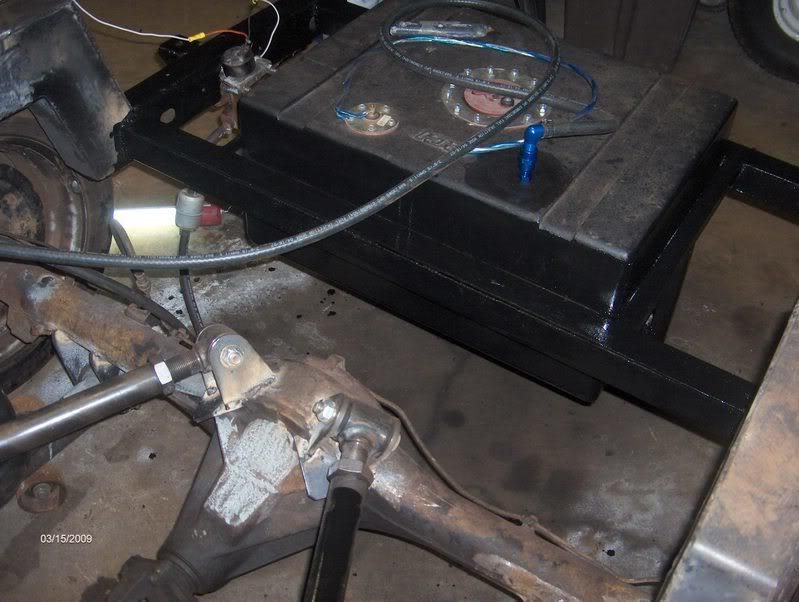

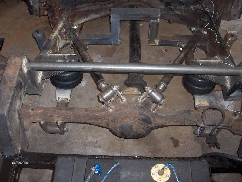

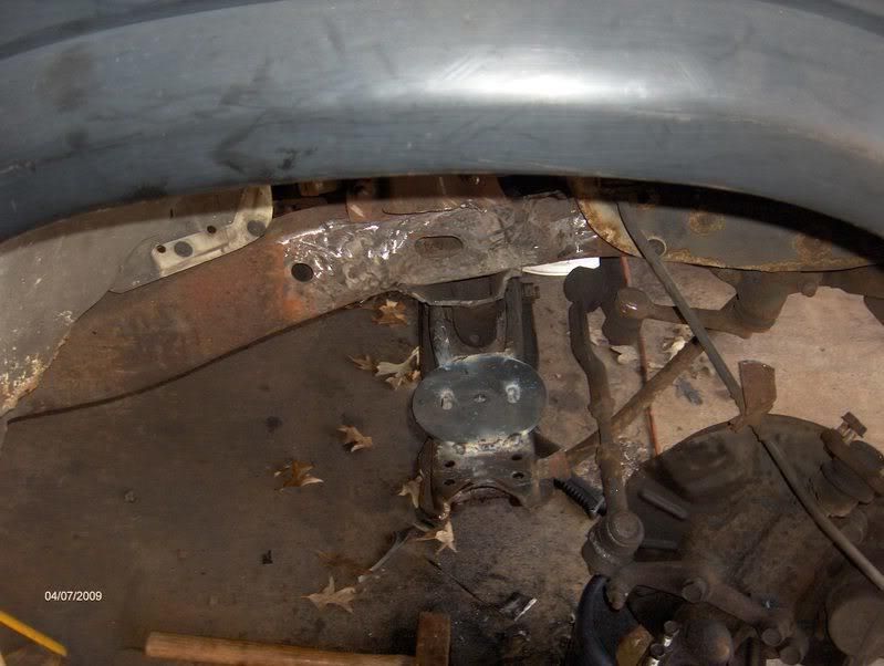

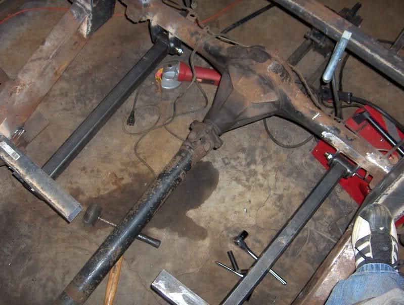

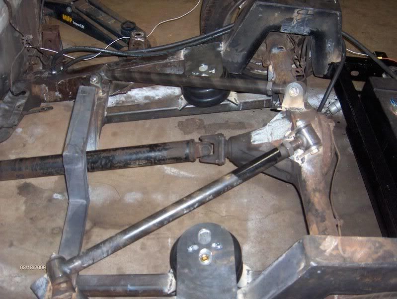

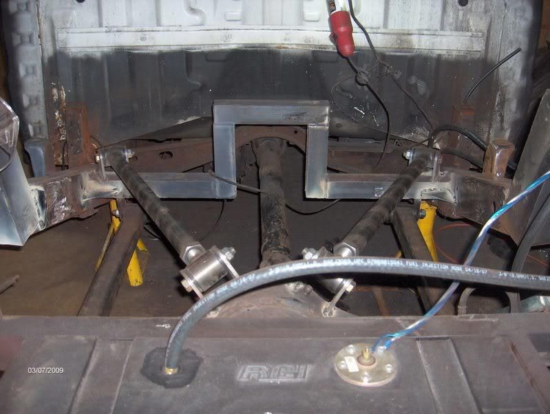

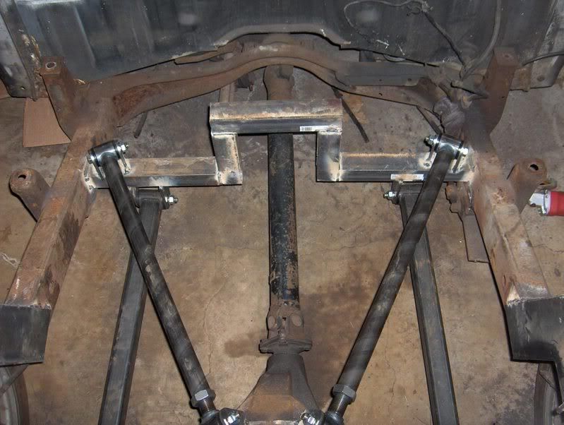

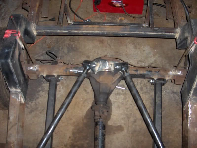

thanks guys. Just got the other lower bar on. Heres some pics.
pimpeasyelil's avatar
pimpeasyelil

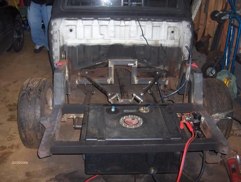

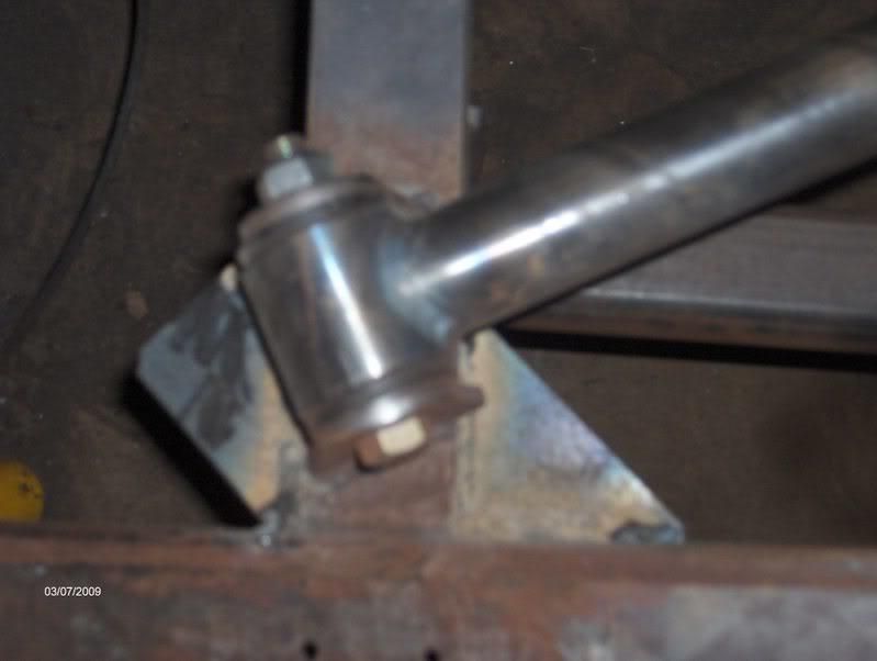

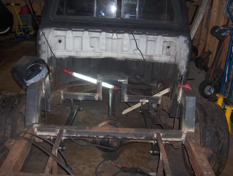

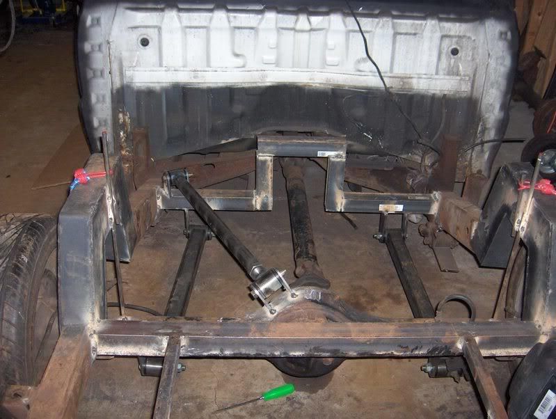

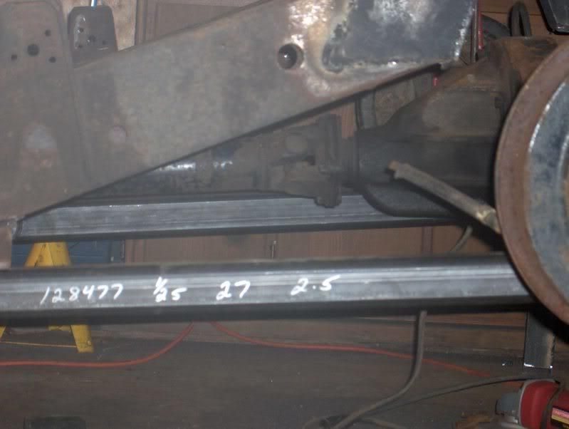

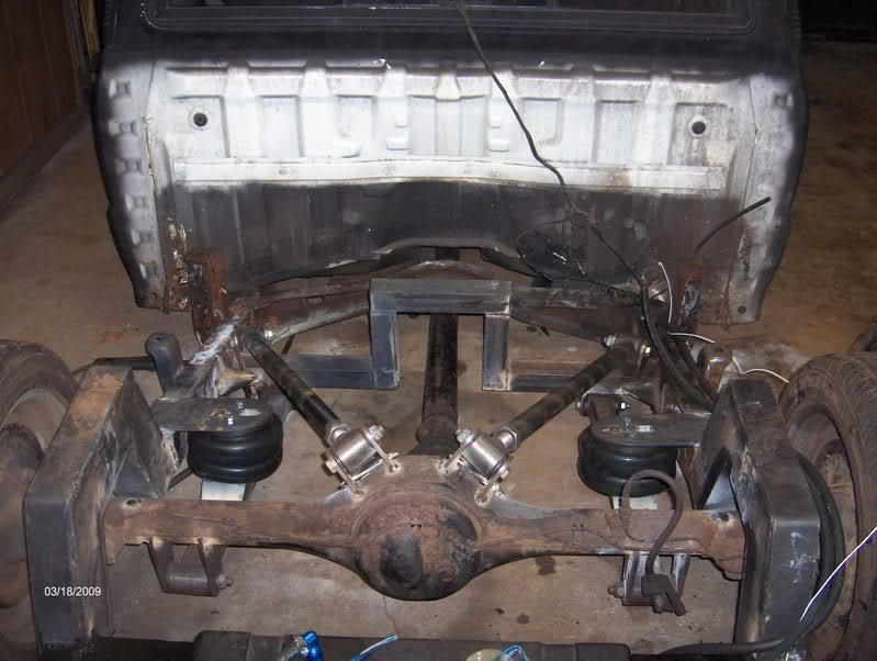

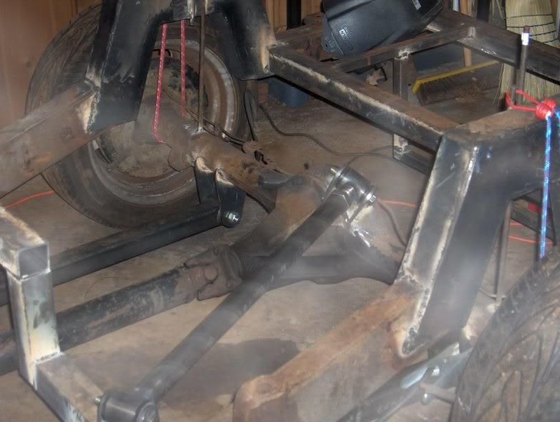

bump for some feedback. first time welding and first time baggin. let me know what you think so far.
E
V
v8mazda4ever
bro looks good so far but I would re do your cross bar as a single piece in the beginning and then add your riser part and then your front brackets for your lower bars as you can see in the pick it is already folding down. I know you are going to add to it but it would work better to put one solid piece across first. Other than that you are looking good. just my 2 cents.
pimpeasyelil
thanks man. yeah i noticed that too. i need to go buy some more steel. It's real hard to get both sides identical when your using two seperate pieces.
