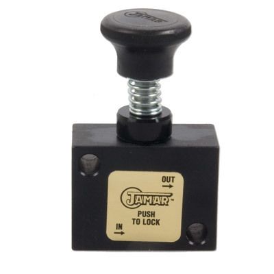

Why not use a line lock instead of all that?
Jamar Park-Lok hydraulic line lock functions as a parking brake. To engage it, the driver
first steps on his brake pedal and then presses the Park-Lok button. The Jamar line lock
automatically disengages when the brake pedal is depressed again.

If I had 4 legs I would use that lol. That's way to Incovient to use as a "ebrake" I like using the handle method and feet for pedals. I can't see me using my foot to tap that brake, tap it again then hold the clutch and rev it to keep the drift.

I thought you wanted a parking brake. It definitely wont work for drifting.
