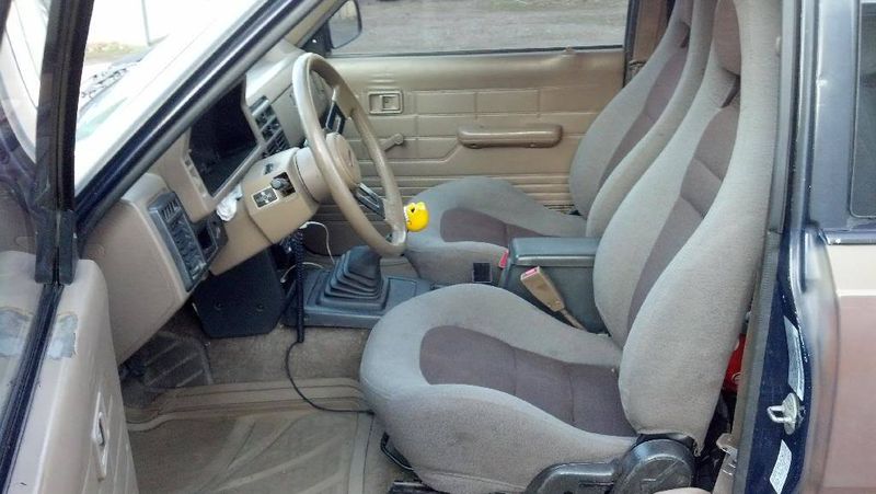

I have heard that 626 seats are a bolt in. Anyone know for sure. 89 Xtra cab.

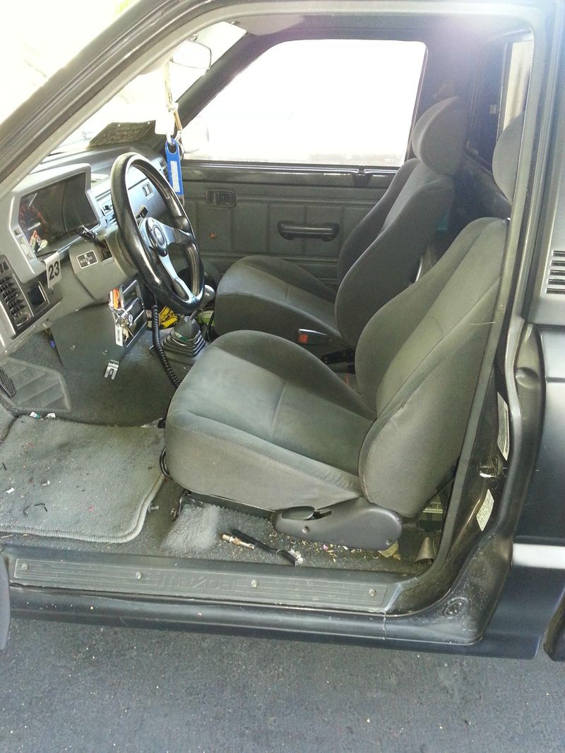

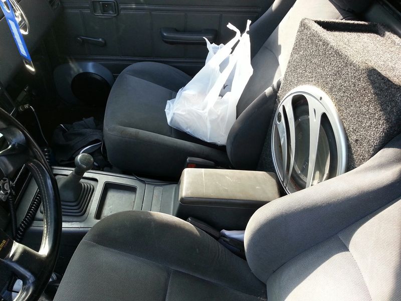

Not sure about the 626 seats but I recently did 2001 Dodge Neon seats.
They are way more comfy then my bench seat and the color match is perfect. The downside - 3 of 4 holes bolt up - they do not fold forward.

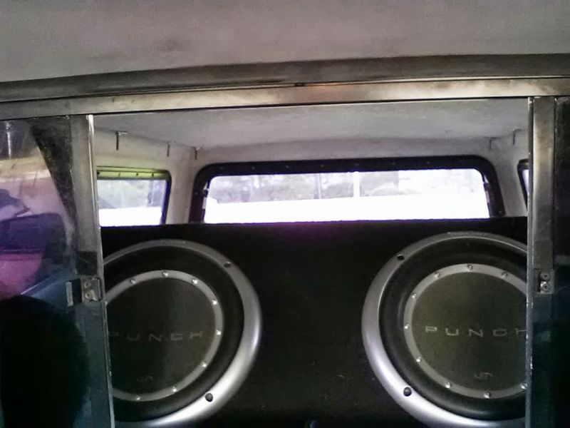

factory console in
new subs on the rear camper shell interior.

Back in 1999, I used mazda 626 seats on my old truck (single cab b2000). Unfurtionetally I cant remember how many holes lined up but, I know it was at least 3. I did no have many tools back them to cut up or modify them so it makes me thing that they must have bolted right up. The doner car was like a 1990 4 door 626 lx.
coloradolowlife
i just pulled a set of buckets out of a mx3 at the junkyard early 90's and they drop in...swap the rails ans bolt them back in ..... and they flip forward...
sorry i forgot, my truck had spacers on the front of the stock buckets you need to use the long bolts and spacers on the inner side (tunnel side) or they will lean in....maybe another couple flat washers to get them perfectly level.
