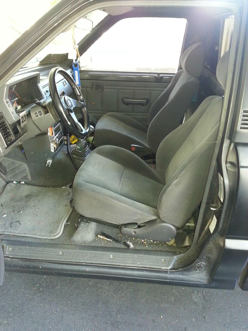

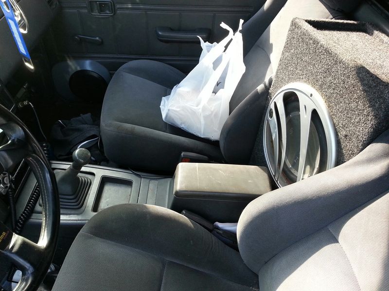

I just put 2000 Dodge neon seats in - There were a ton of them at the JY, but finding the style that didnt 'look' like neon seats was hard - there were two kinds of neon seats in that year but only one wasn't ugly (see the pic) color match was perfect though. Had to bend the front bolt mounts a little (smack it with a hammer) and get one longer bolt for the front... 3 out of 4 holes line up and I haven't bolted through yet for the 4th. I'm not too worried about it I'm good with 3of4 (they don't move). They are way more comfy... the main problem I have is they don't fold forward and now I have to build a new box bec my sub doesn't fit!

Wow sorry I forgot all about this post! I really like the neon seats they look pretty good. About how much do they go for? And the size is an issue as I also have 2 subs in my truck hahaha I have about an inch from my wheel to my stomach!!
