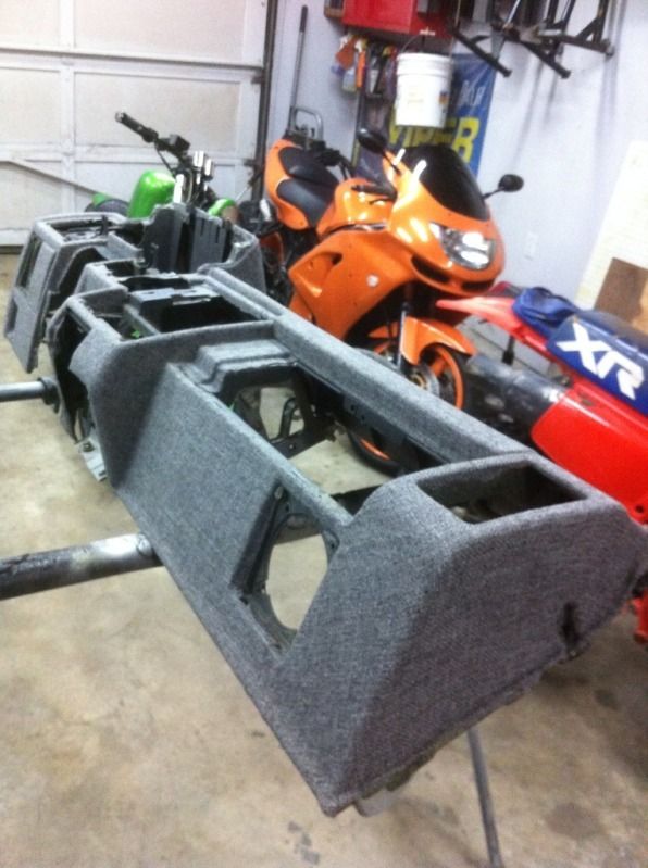

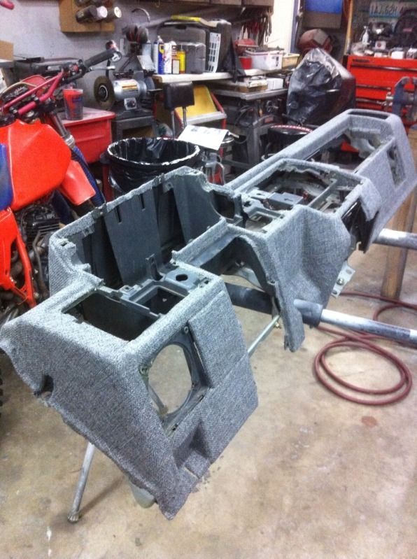

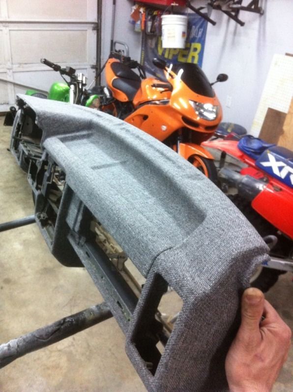

I wrapped all of my interior in tweed it's pretty easy to work with. It doesn't stretch at all but is easy to hide seams in. Here's some pics of how I did mine. I had a solid 6 hours in it. The top and sides are all 1 piece. The bottom is I think 6 separate pieces I put seams in the corners

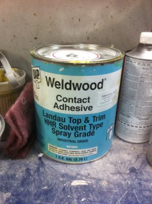

This is the glue I used. I sprayed it on with an old siphon feed gun

Wow....thats all I can say!!!

Ya thats impressive!

Thats pretty nice, did it contour very easily?
Most dash work I've seen done is in vinyl and the old heat gun helps stretch but tweed isn't as flexible I thought.

dang, that came out killer

Tweed doesn't stretch at all buy since its woven together you can shift it to get around the bends. Here's a pic of the rest of the interior
