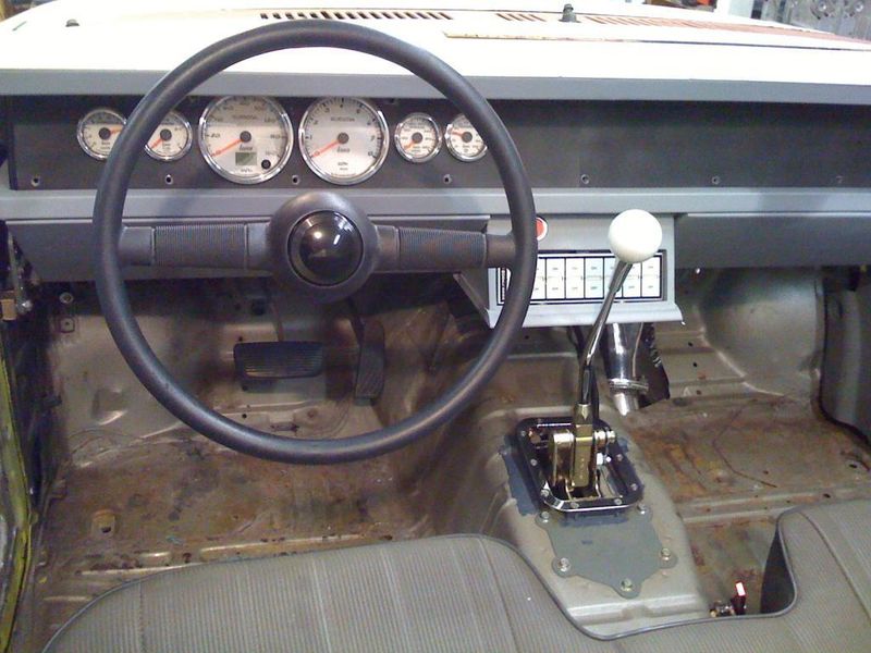

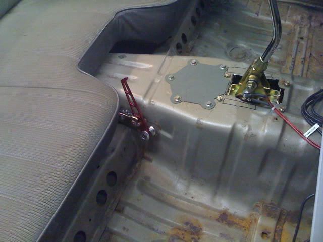

Here is a picture of the modified original B shifter for left side shifter (have to disassemble completely, heat destroys stuff, heat each place to bend red, bend, cool, move to other bend, heat red, bend to shape, let cool reassemble. May want to replace the bushing in the shifter at this time.). The shift rod has 3" of 5/16" all-thread welded to the end. The piece going through the shifter has a 3/8" nut welded across the end of it. Drill this nut out 1/64" over 5/16" diameter, use a 5/16" nut on each side of this nut to adjust rod length, and lock it at that length. I had 3/8" square stock laying around in abundance I used for the shift rod, round of course "looks" better.
I can upload a print of the transmission lever if anyone need it.
The pictures are with it in park. May not pull low gear, but who does, install a shift kit.
This keeps the interior original for those of this mind.
