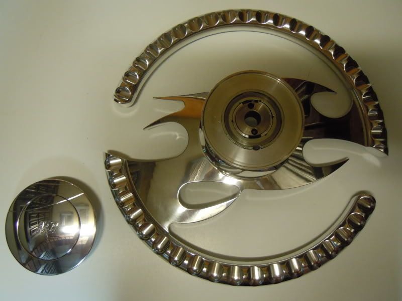

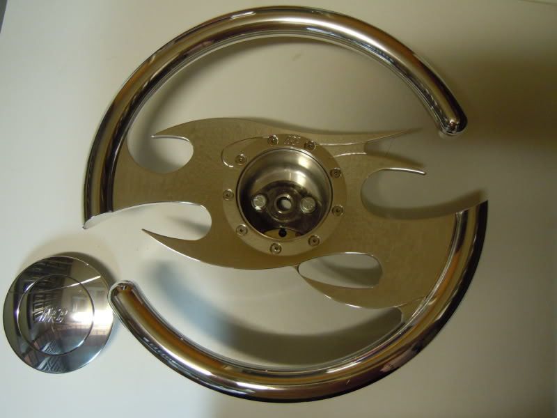

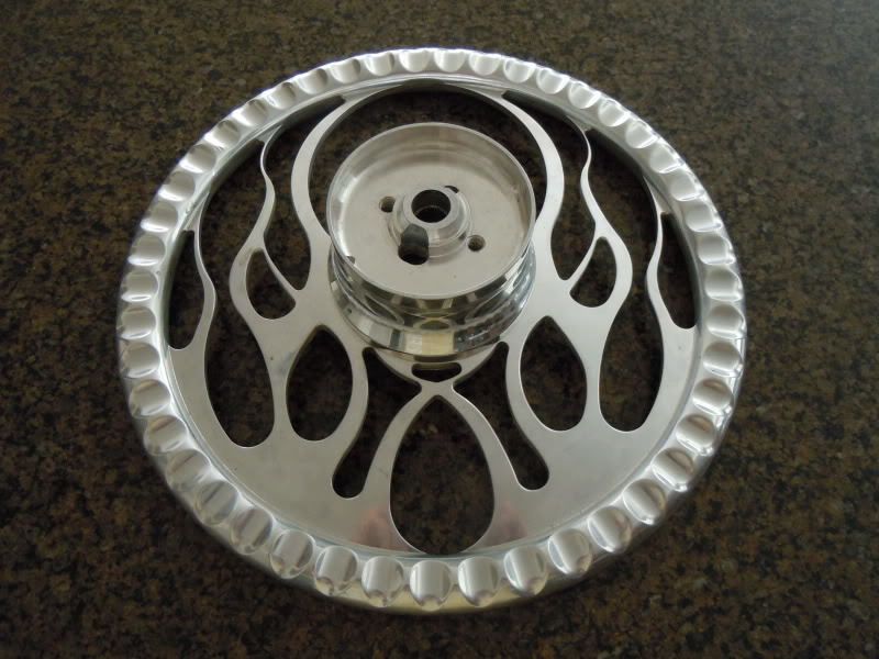

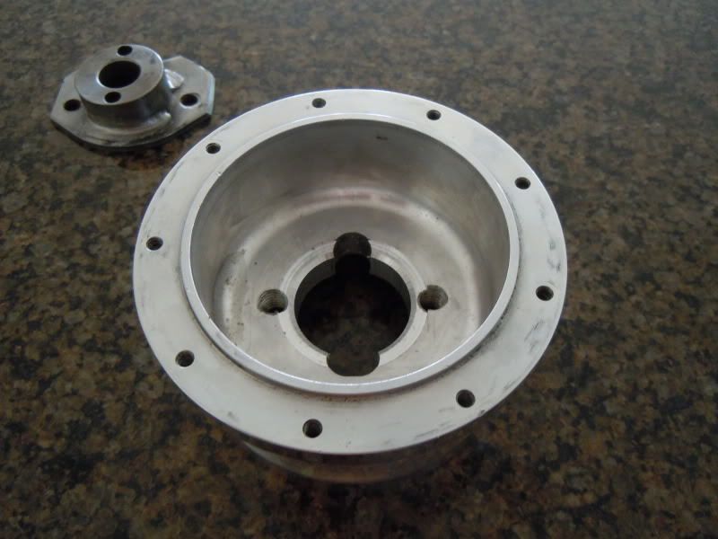

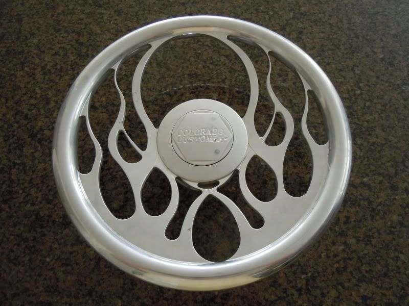

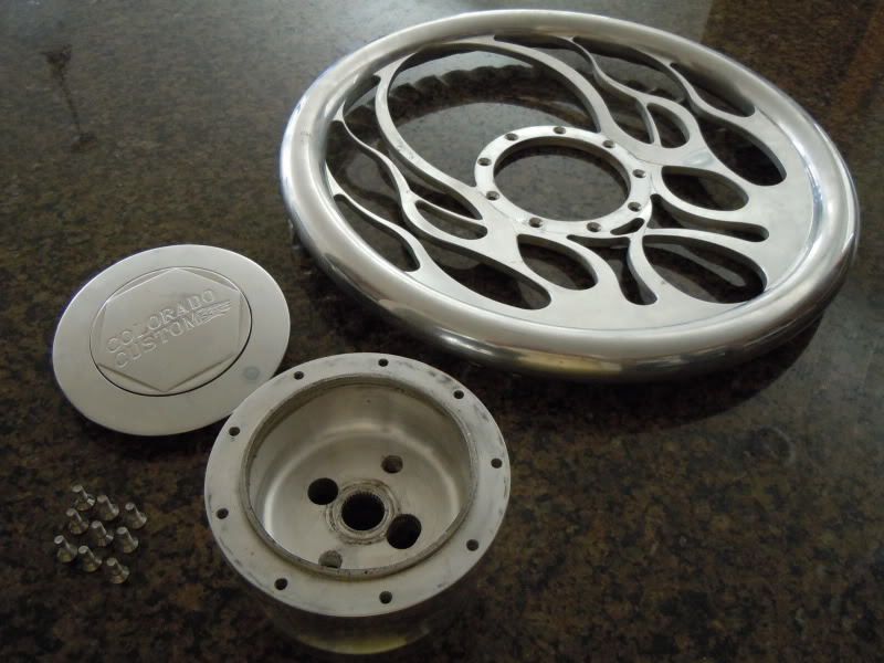

This is the wheel we are going to use.

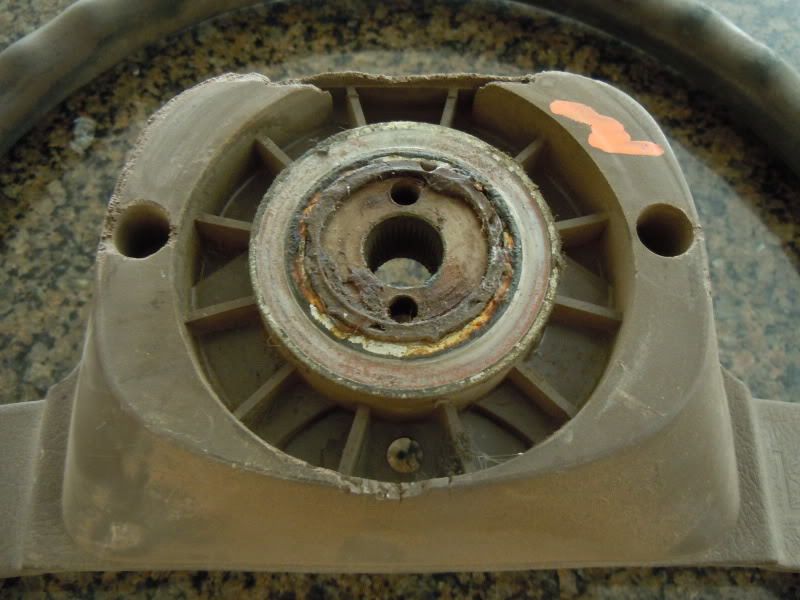

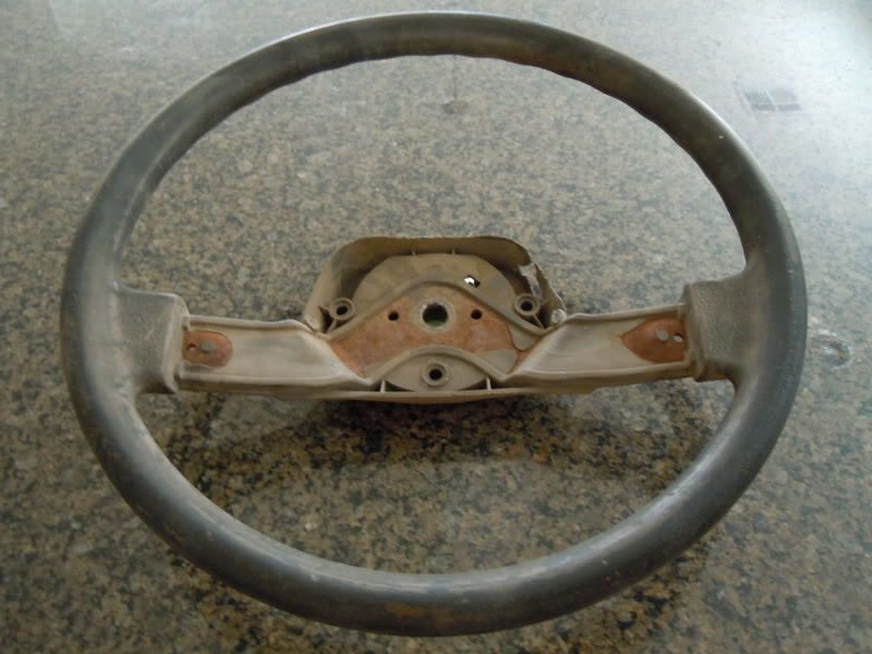

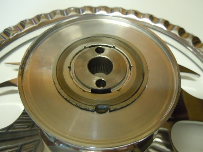

First, remove your stock steering wheel or get one from the wrecking yard. When you get it off it should look like this (see picture 6.)
6.
7.

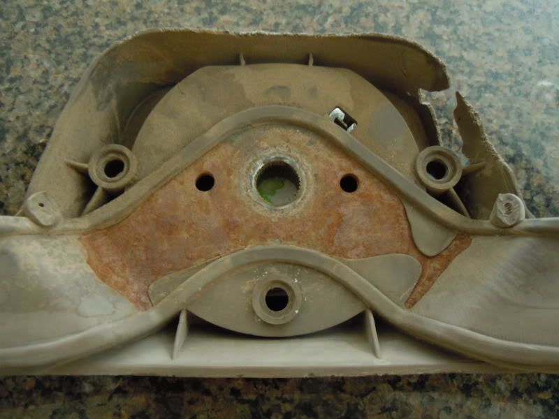

On the back of your stock steering wheel remove all the rubber from the center, so the bare metal is exposed
8.

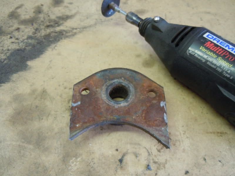

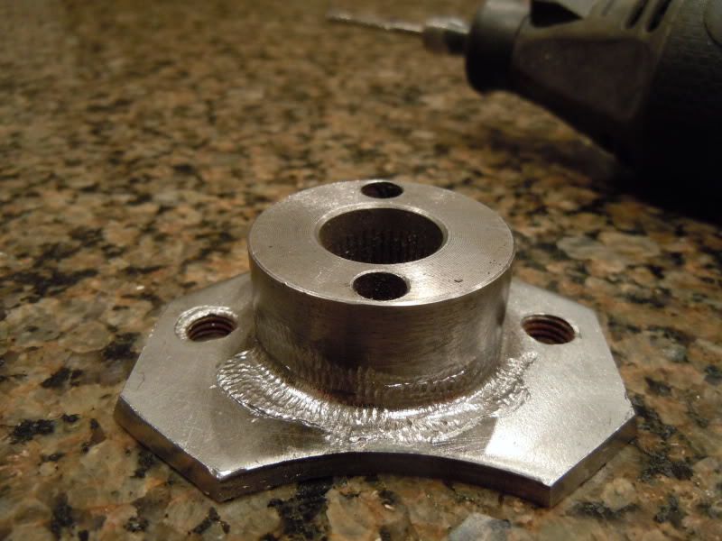

Flip the steering wheel back over (you should be looking at the front). Now measure 1 1/2 inch from the center hole and mark it on the left and right side. Draw a vertical line where you placed your 1 1/2 inch mark. This is where you will make your two cuts.
After you had made your cuts it should look like this. (see picture 9. & 10.)
9.
10.

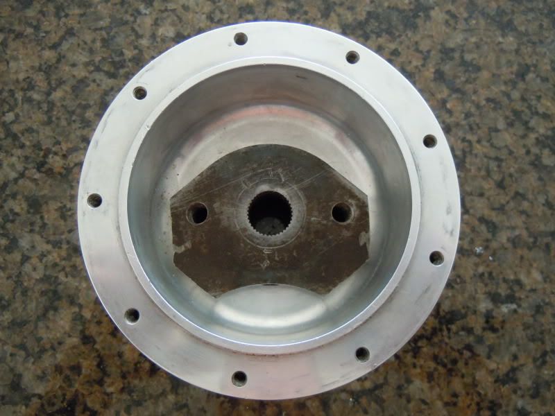

The way I cut mine it still didn't fit inside the hub adapter, so I had to make two additional cuts. After cutting off the two points it fit inside the hub.

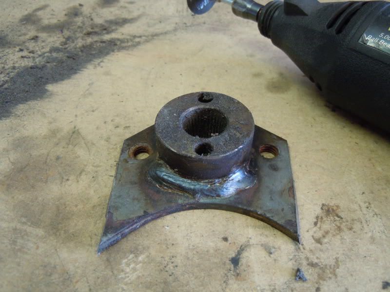

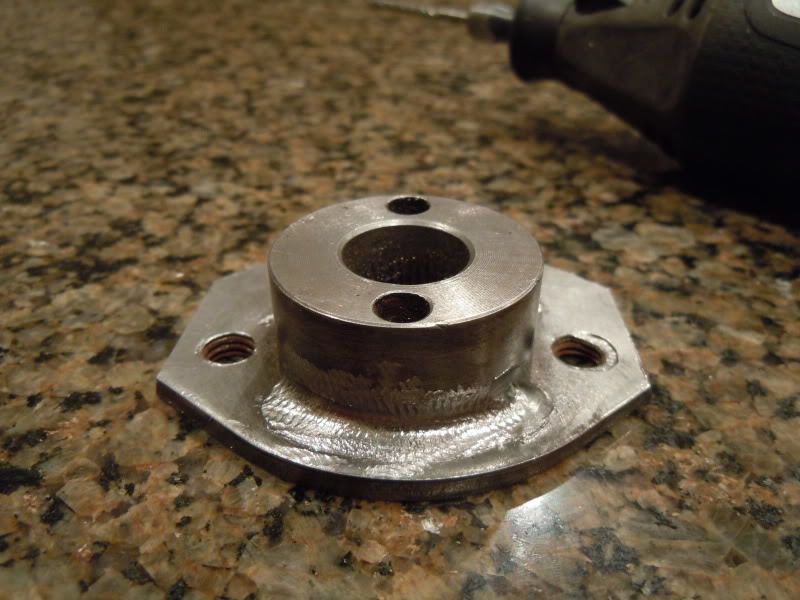

Then I took a round file to the weld around the base of the cylinder. (see picture 11. & 12.)
11.
12.

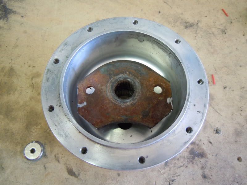

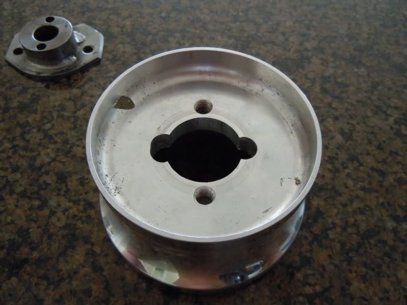

The two smaller holes on the outside will need to be drilled out to fit the bolt through. I used a 25/64 drill bit.

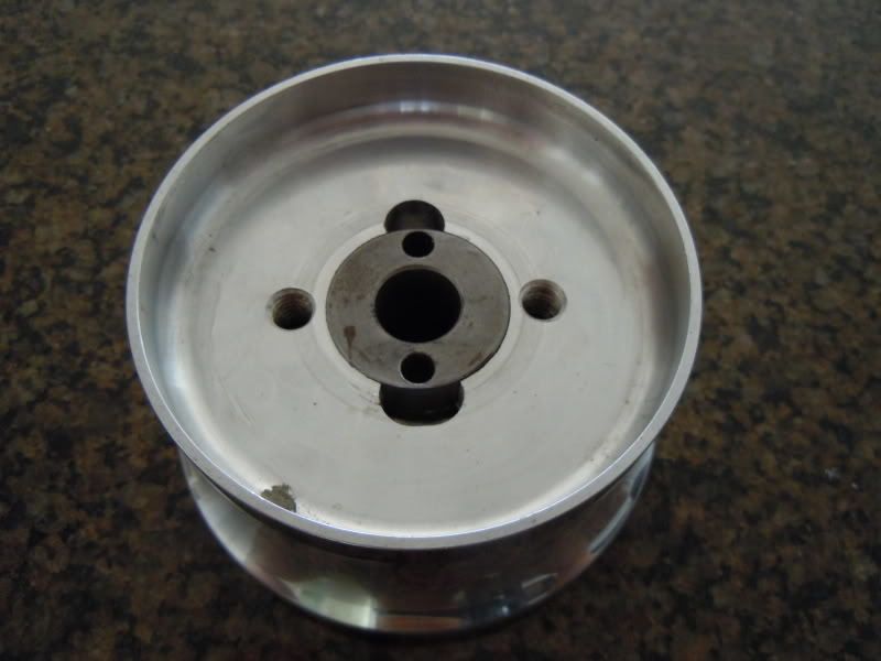

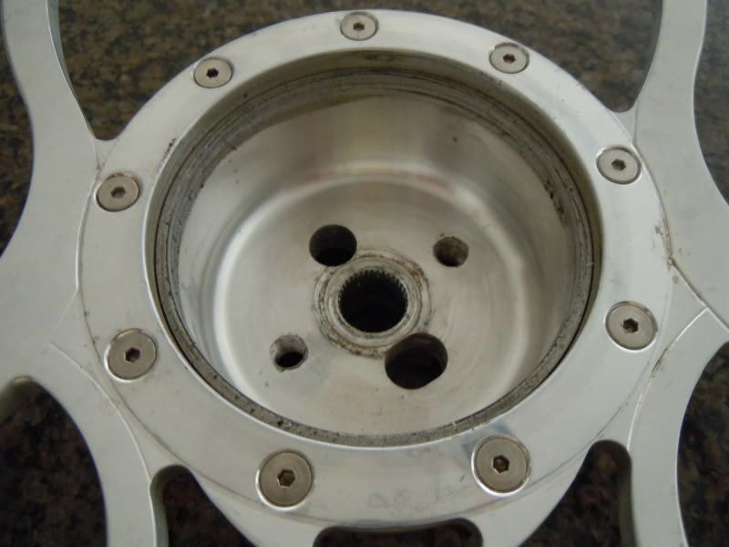

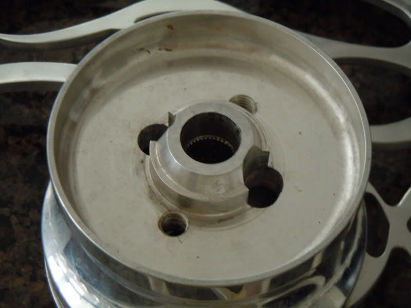

Now you can have a machine shop mill the center of the billet hub, so the smaller piece will fit all the way down inside the billet hub.
Watch the video of the hub being milled on the lathe.
13.
14.
15.
16.

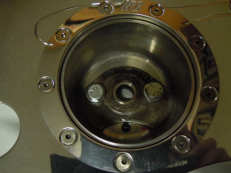

Now you can put two 9/16 bolts in the center to hold your hub together.
If you end up hooking up the horn, you will need to drill a small hole to put the tab through. I put a small piece of plastic around the connection. Other wise your horn will always go off.

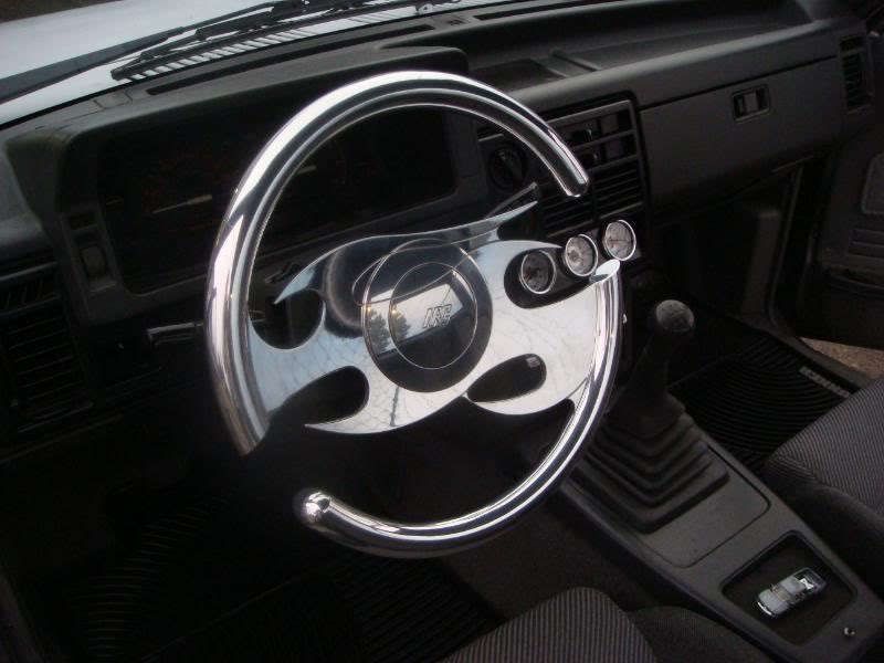

Here is a picture of the first one i did.

89mazdalade, The second steering wheel I posted is made by NRC and they call it TRIBAL. Here is a link to it:
