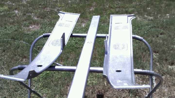

Thanks for the idea on the wiring but onto the panels I don't need door panels I need all that shit u put behind the seat to cover the metal of the back of the cab. And is there any trim what goes around the seatbelt pillar ect. And color isn't an issue I like to paint plastics thanks again and sorry for the delay on posting but I've been busy

This is what Im looking for.
Thanks as always for any info

I think I have them on my parts truck they would be tan send me a pm so I can get back to you it will be Thursday before I know my parts truck is in a did county and I can't get out there before then

Dude, if you get totally stuck...... I have most of the cover bits you need that id pretty much give ya, only problem is how bad the shipping would be from Australia to the us..... Size and weight wise its gonna be around 150 at a guess from last time I got stuff shipped here from the states.
