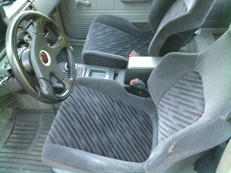

Going to try it...was sitting around and realized I have an extra set just sittin there....Anyone ever tried this to save me the headache?

Also from basic measurements , diddnt get around to installing they have the same mock up , the curve at the front is almost dead on but i think the 300zx rail is a tad bit longer in the back then the b2200. I will post again when i know for sure.

I have Prelude seats in mine and what I did was drill off the stock Honda rails and bolt my Mazda seat rails to the Prelude seats. It took me about three to four hours total time to do both.
I did not want to drill holes in the Mazda floor or make any kind of plate/brackets.
Those Nissan seats should be power so you may want to run wires to them and enjoy their electric goodness.

300zx seats came as power for driver and manual for passenger. Due to the lack of room and the custom console im building going to be kind of large I may rock two passenger seats for size\wieght difference. There is about a 30lb difference for each seat between electric and manual. Its been rainin so no progress yet.

I am going with the same seats, I have gutted all the power stuff under the seat so i can stuff amps under the seats.
Gonna have to weld the rails so there
not moving on me.

I just put these exact same seats into my 2600i this past weekend.

Yea I picked mine up cheap. My stock buckets were worn and torn and these didn't take much mods at all, plus they're pretty comfy in my opinion
