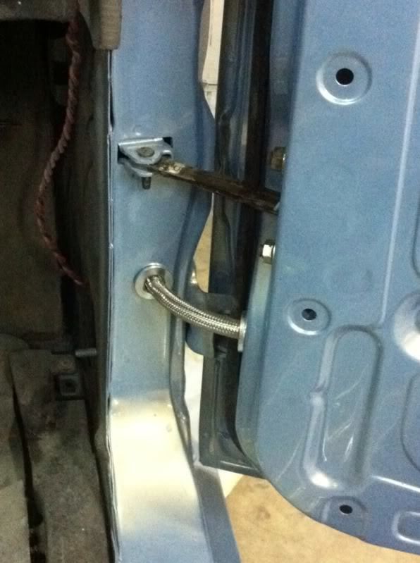

how do you run wires where it doesnt look like shit?
ulrich's avatar
ulrich
I didn't.
It looks possible, if you take the time. Out in to the front fender, then back a little an existing, ~.75"x1.25" hole in the front edge of the door. I'd be sure to protect the wire heavily.

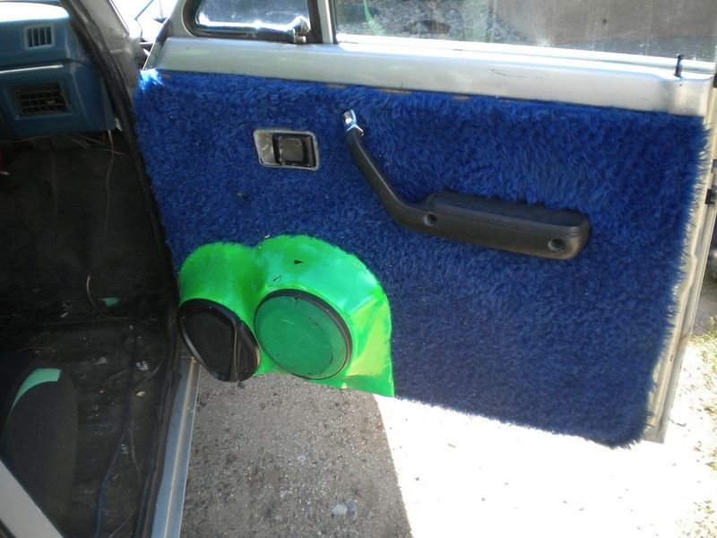

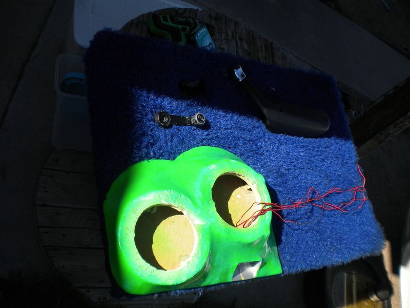

this is what I did. works great
