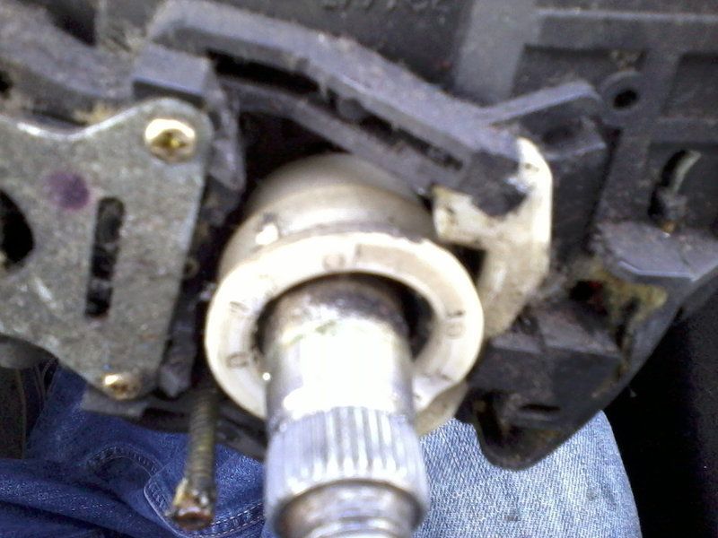

Whenever i use my signals and complete my turn they do not click off and i have to click them off manually. how do i go about fixing this?
stock steering wheel?
addiktion's avatar
addiktion
no, its a gt.
take off the wheel you will see two black nubs they need to go in the holes on the adapter the black nubs are on the turn switch itself they need to be one up one down
they arent in the holes thats why its not workin

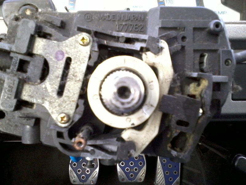

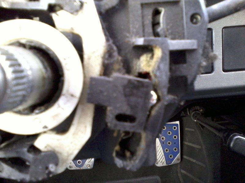

so this is my turn signal switch, i have no clue what to do.
bagged2.2's avatar
bagged2.2
they look broken... there should be an upper and lower plastic piece that sits in the back of the wheel adapter...
your nubs are broke off

thanks for the help guys, now i know all i need to do is replace the whole switch
