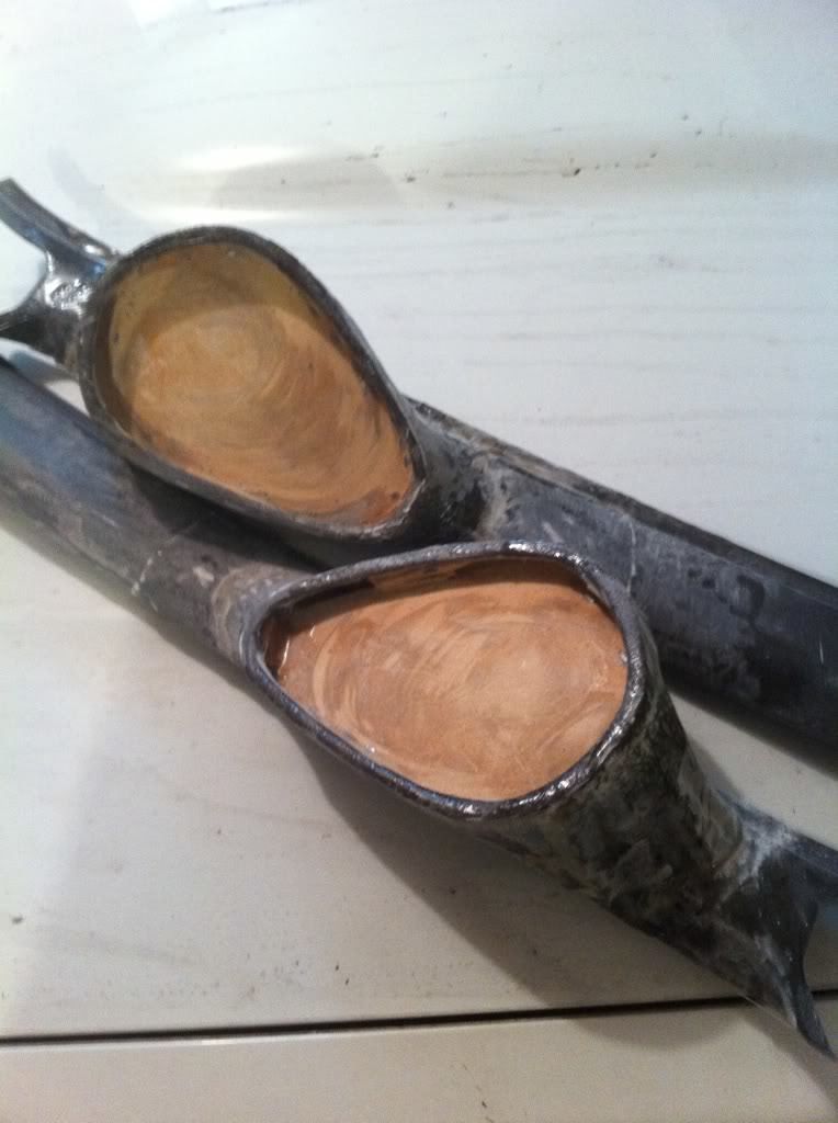

Figure I'd post these here so if someone needs help with anything. Kick panels bult for 5 1/4 and tweet, A pillars built for 4" and tweet. Heres a few pics.

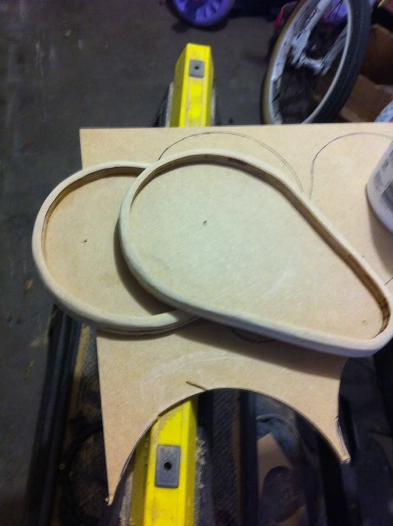

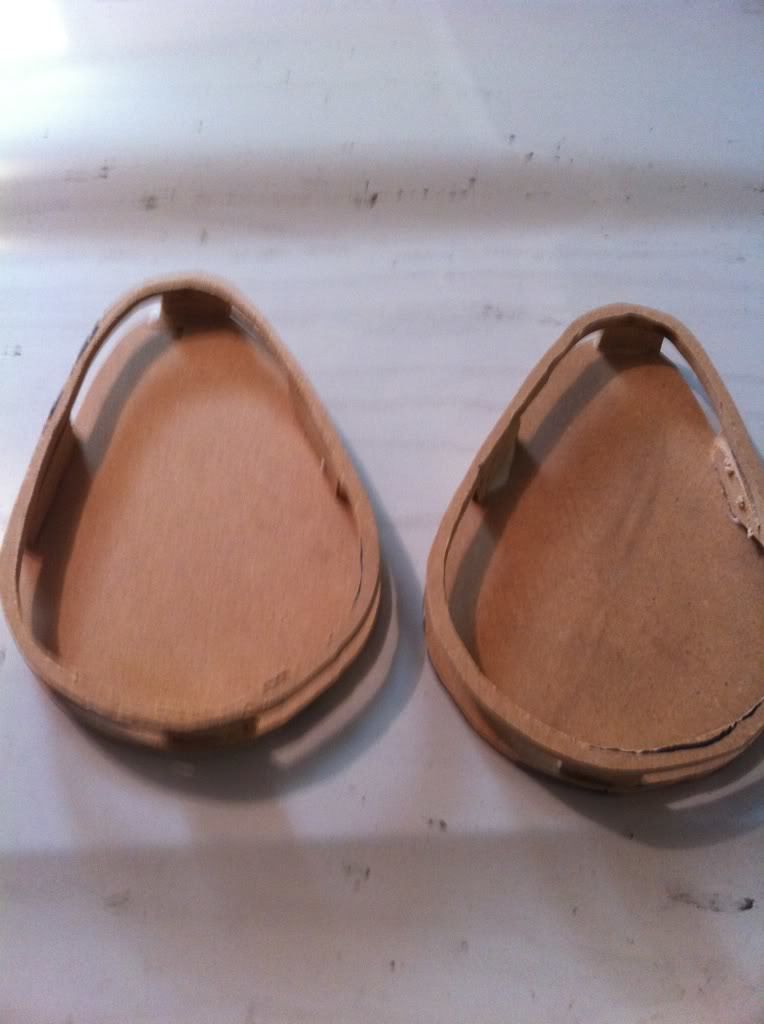

these are the wood pieces for kicks

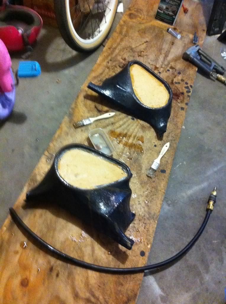

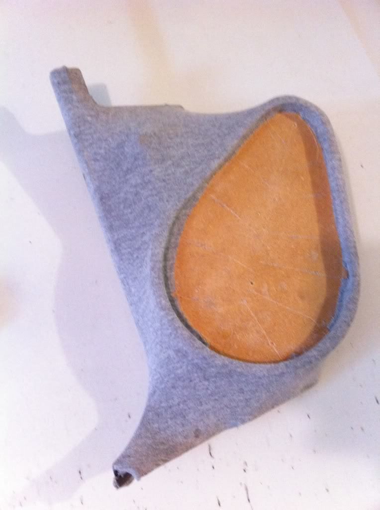

wrapped waiting on resin
resin applied on kicks
wood pieces for A pillars

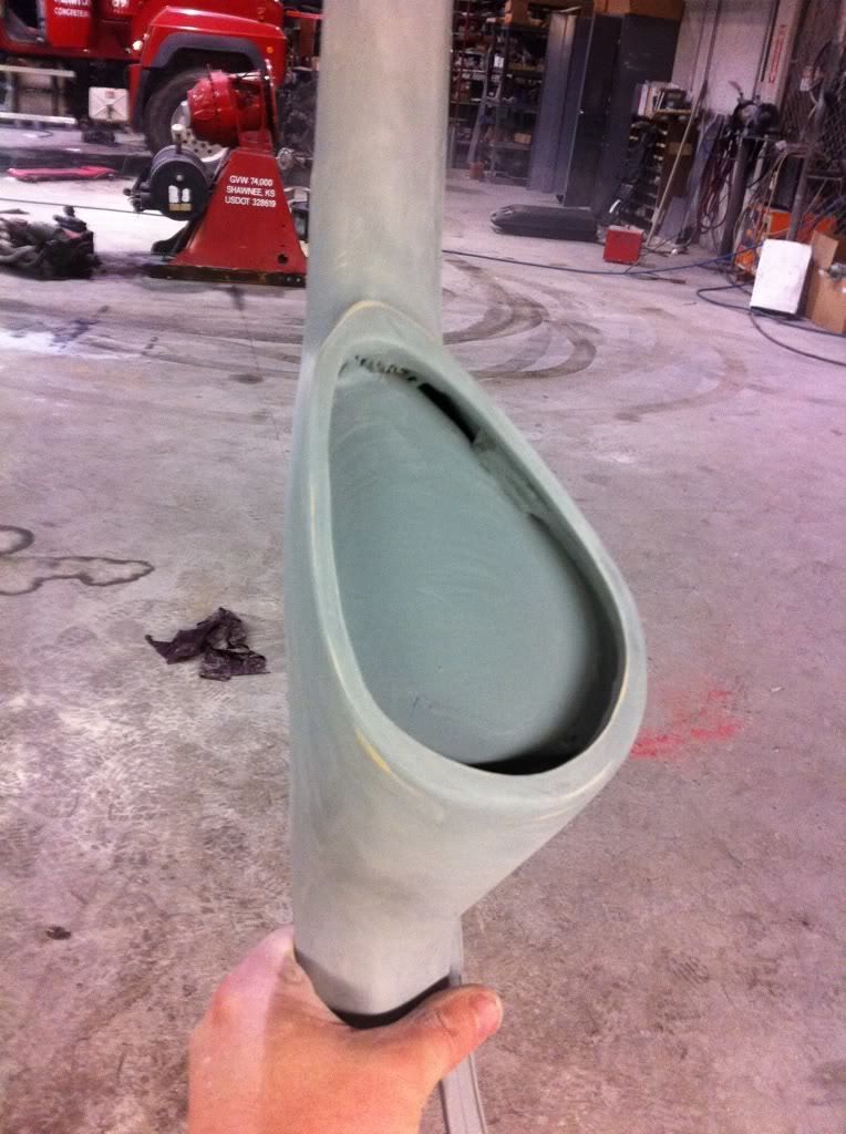

resin apllied to A pillars

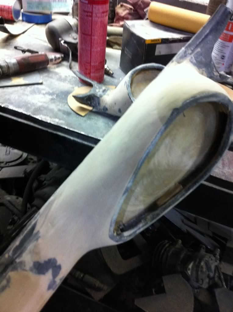

after bondo and a little sanding
after primer

id like to see final product of the a pillars. i need more sound and i think that might me a good idea.

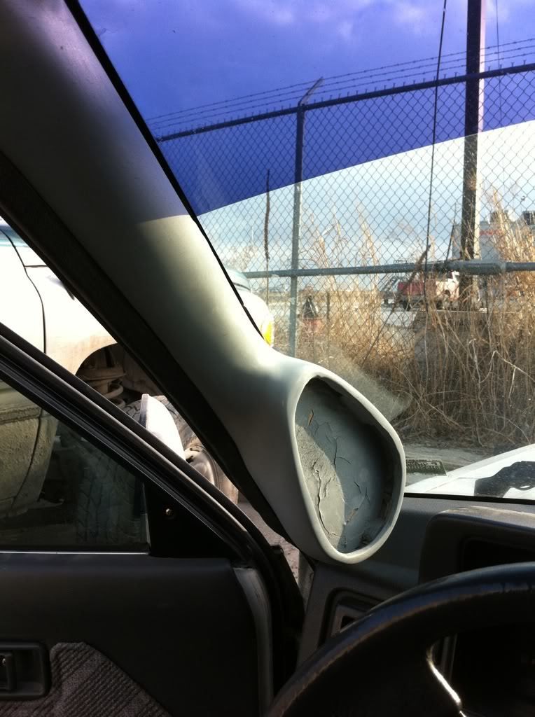

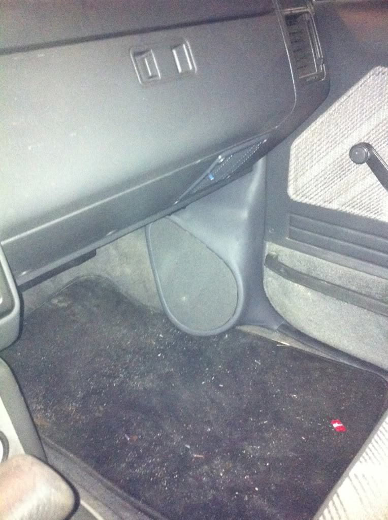

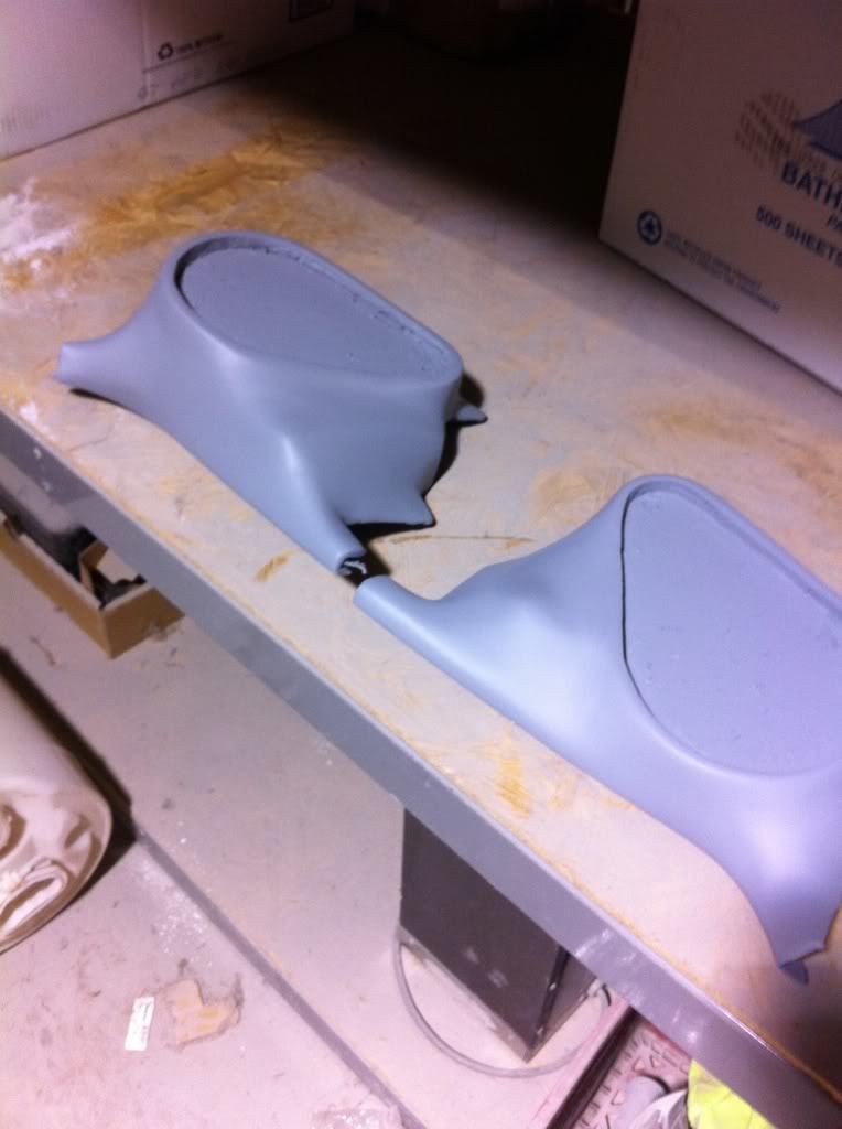

I'll get some pics mounted soon! Saving money for the speakers. Everything is done being primed. Needing a color? Let me let them cure for a day and I'll snap some pics mounted. Heres kicks all primed
Those came out incredible, nice work! What color are you painting them?

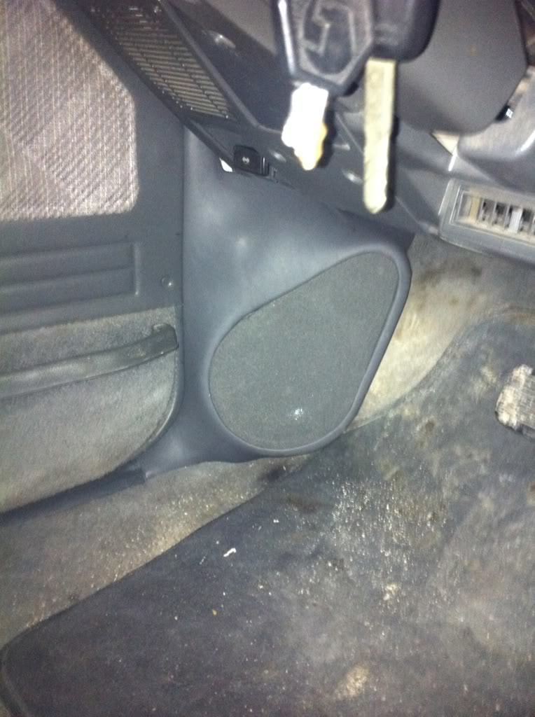

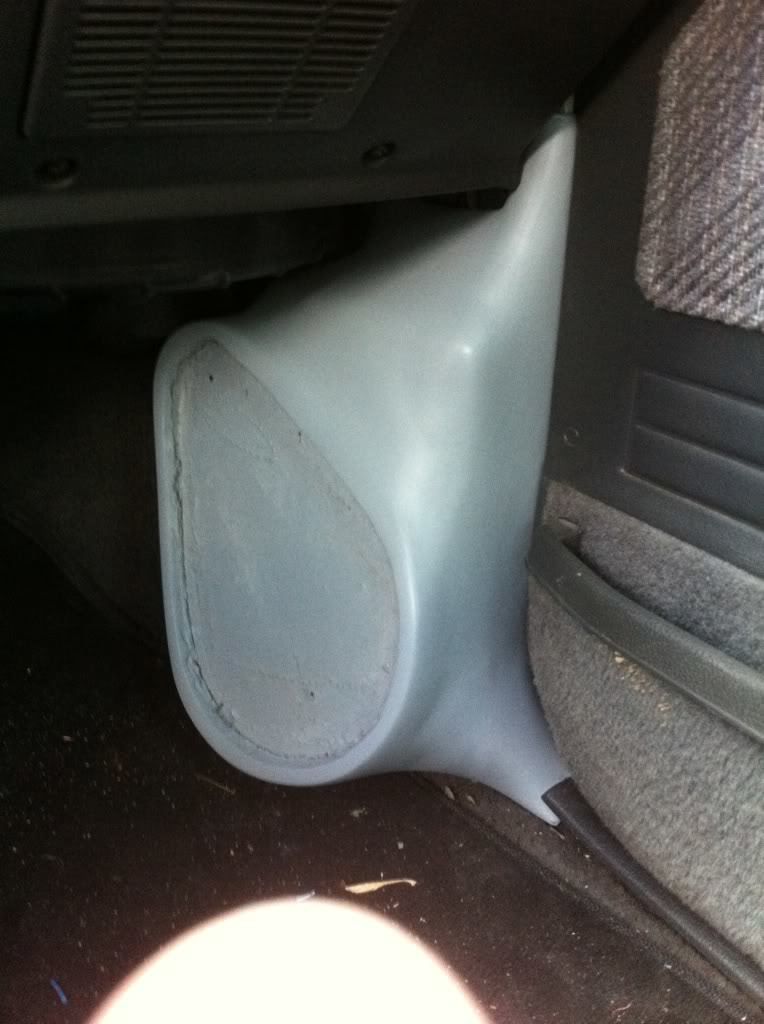

test fitted today. Still got a liitle more more to make perfect. Started making grill inserts. Cant find any grill cloth. Anyone know a store?

Those look sweet bro

emjay
hmmm, I think that you just showed me how I am going to get my pod gauges to look flush on my A pillar. question for you though, how did you prep the a pillar to take the fiberglass so well? and for the bondo you did the thin layers like you would for body repair, correct?
