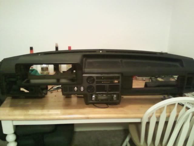

if i clean it, sand it, and plastic primer it, can i use any paint i want? or do i still need to use vinyl/fabric paint or plastic paint such as SEMs, Plastikote, Dupli-color, or Krylon Fusion?
i would also like to know if anyone can help me with filling in the gaps on the sides of my deck? this is my first project so i dont know a whole lot like glassing or anything like that, plus im working in my apartment lol.
Yeah it should be fine after the plastic primer. Do you have a spray gun?
To fill the gaps I would cut a flat piece out of metal, and inset it similar to how you have done your deck and paint to match.

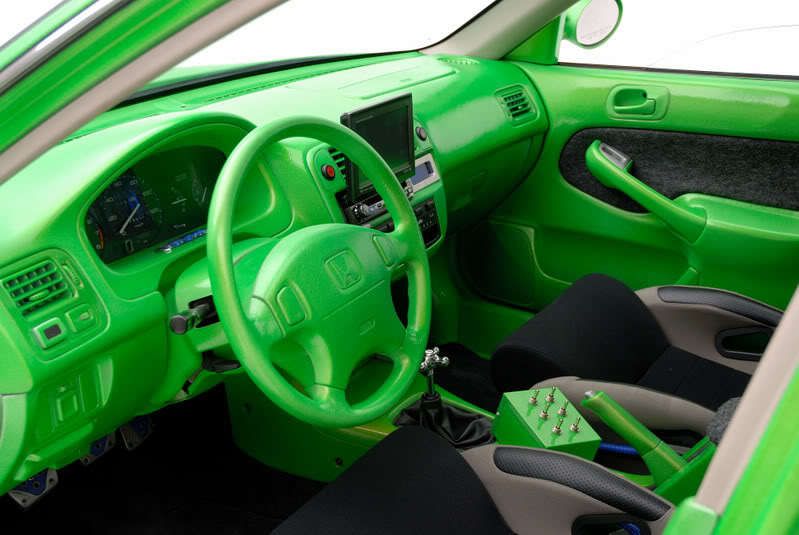

wow, that is green! lol
ridinlow84
Yes, I agree. Very green!! What would one be thinking to paint the whole inside that color? Afraid of not see the inside at night time, lol?
robzilla's avatar
robzilla
HAHA, yes it's bright. I've had people say they have never seen so much green in there life. It's also covered in metal flake.
Now get back on subject!

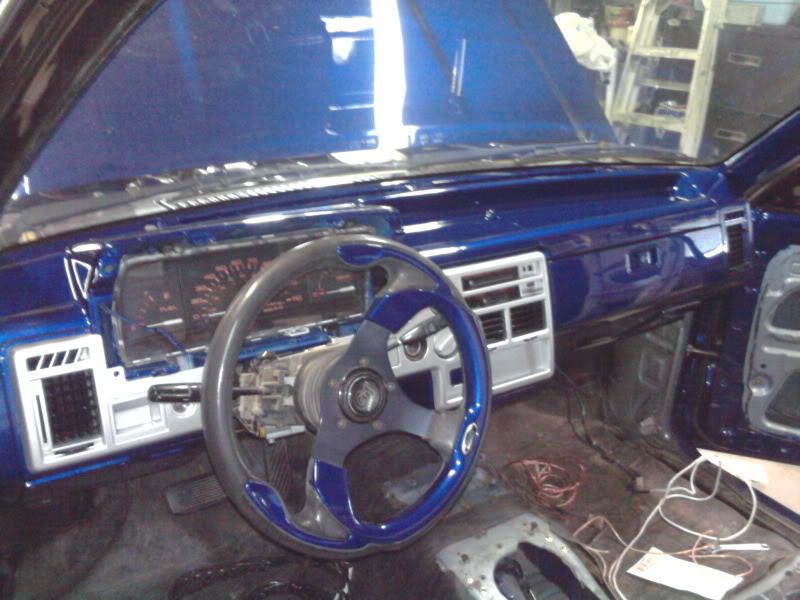

idminitrucker (jason)
If you want it smooth just make sure you sand all the texture out of it before you prime it. if you try and fill it with primer it will want to crack out. I sanded mine with 120 then 180 the 220 then 320 and then wet sanded it with 400 then put 3 coats of primer on and let it sit for as long as i could so it would get all the sovents out that it could.
