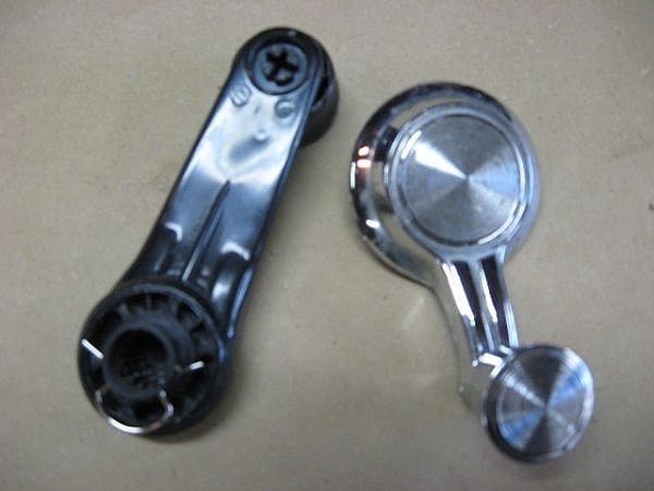

When removing the window crank arms is there a C clip on the exterior of the door panel? I was unable to figure out how to remove the crank arms
thanks!

grind em off haha mine didnt have any when i got it so no idea
bagdb2200
Yes, there should be a C clip on the backside of the window cranks holding them on.
This isn't a Mazda crank, but they're all the same concept. You can see the wire C clip halfway on the backside of the left one here.
