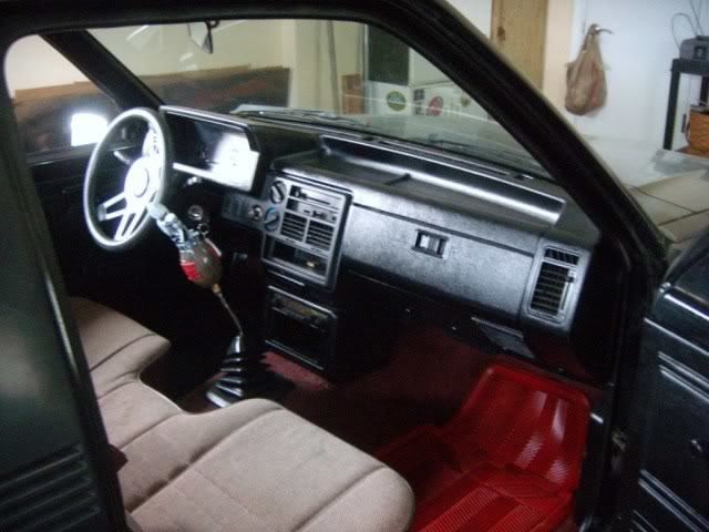

Not the best pic but its just dyed black with duplicolor vinyl and plastic dye
I wanted to find a red that matched the Mazda red but I couldn't so I just did black. I think it turned out pretty good
