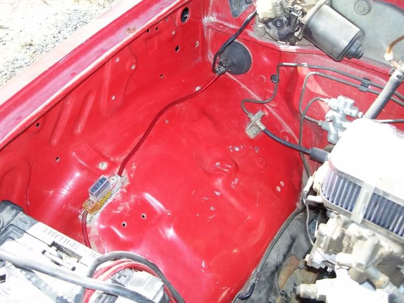

i have a weber carb and about to tub my firewall and want to clean up the wires coming out of the passenger side firewall, what can i get rid of as far as the computer and wiring, thanx i know the wiper power has to b kept. lmk thanx
dragginmazda86 (dave)
You have it down exactly, all you need to keep is the wiper wires. Heres a pic I just took of my daily driver, all I have is the wiper motor wires, and a wire for my amp coming out the firewall. As for the fuse block thats mounted to the inner fender I moved it in front of the battery tray.

dave you didn't have to extened any of the wires for the fuses that you moved did ya?
^^ If i remember right I just had to extend the wire from the fuse panel to the back of the alternator, and the wire from the fuse panel to the positive battery terminal. As for the rest of the wires they are in the "head light" harness so they are actually kinda to long.
