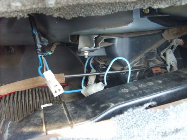

like the title says.. heater isnt working in the 86 b2000
i know it was workin before.. but my dad told me this morning that it doesnt work (he drives is daily for work)
so i went out and tore it all apart to see if something was apart and there wasnt..

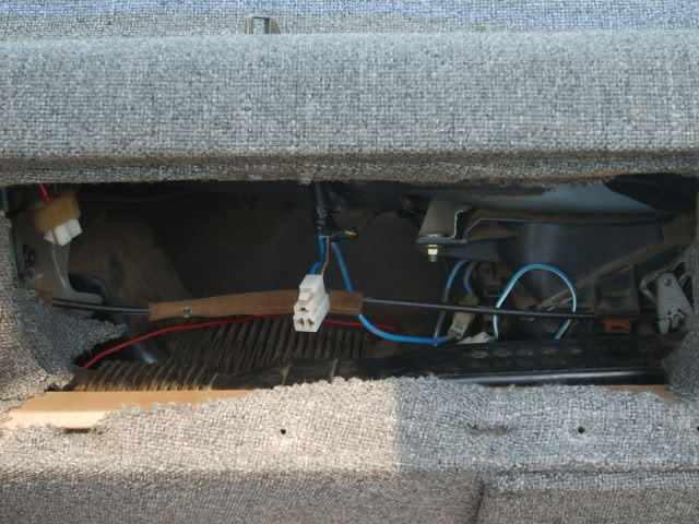

although there is this one plug-in behind the glove box that has 3 wires thats not connected.. ? ? idk
and theres 2 prongs on the heater motor that seems like something should be plugged in ?? idk
can i get some pics.. or better yet just some suggestions and ideas.. i need the heater to work for when the windows fog up..

take pictures of your wires and show us cody. do the interior fans just not work anymore? is it just not getting heat anymore but still blows air... give us some input... need input

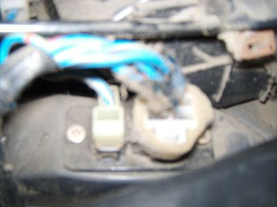

Have you looked at your resistor in the blower housing yet? They fizzle out a lot.

well your wires hanging down might be part of your problem... look on the blower motor where the wires hook up to the motor itself... if nothings connected that might be your problem... you did mention having wires near the motor that were just chillin...?

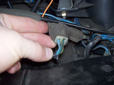

://lh5.ggpht.com/_TPWuvwktPFA/SoyJAqV-JUI/AAAAAAAADuI/irC-dN4HyKY/s400/HPIM0911.://lh4.ggpht.com/_TPWuvwktPFA/SoyPAbkmxBI/AAAAAAAADuk/0KIHmMmaCbE/s400/HPIM0904.://lh5.ggpht.com/_TPWuvwktPFA/SoyO_f8v12I/AAAAAAAADuc/Z-TnDg4xDuA/s400/HPIM0906.://lh4.ggpht.com/_TPWuvwktPFA/SoyO-U6SHrI/AAAAAAAADuU/HSx89B9sHVY/s400/HPIM0908.JPG
Here's a few pics fire fox freaked out i'll get some more up. are the 3 wires you see blue? all the wires behind my glovebox are hooked up.
Post was last edited on Aug 19, 2009 11:56. Edited 1 time.
first pic is the resistor unscrew it and see if the coil springs inside are broken

resistor is fine.. i took it apart and checked it out..
^^ the wire blue on the left isnt on mine.. crap??!!
^^ Those 3 wires next to your finger are there but arent plugged into anything and nothing near by to be plugged into..
are these pics a b2200? mines a b2000 and seems like the wires you got are different.. hmhmm

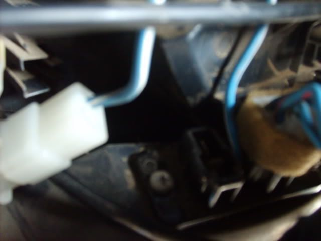

91b2200(cody)'s avatar
91b2200(cody)
cheated my computer and took the pics from my cam to my thumbdrive.. lol
my computer is saying that its low in disk space whatever the F$&* that means.. lol i do need to fix it sometime tho..
heres pics..

nonamedsomebody
That is the b2200 wiring..
