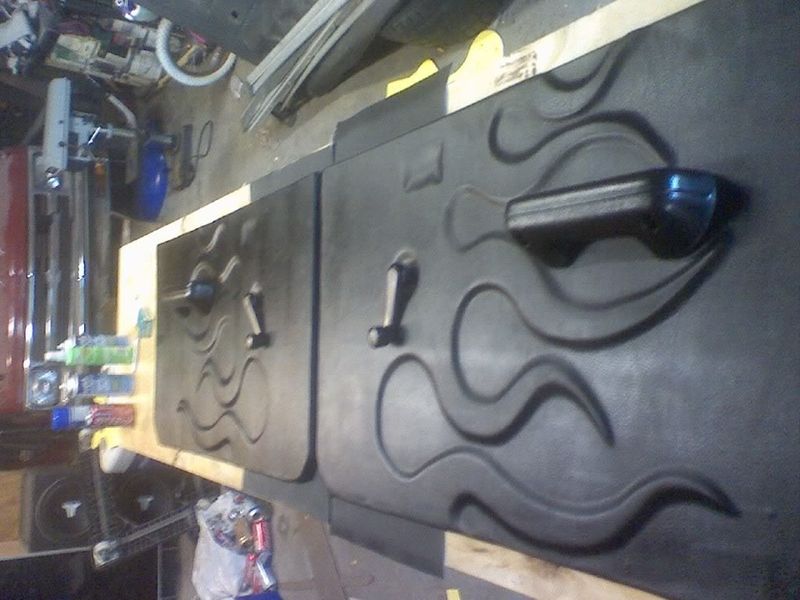

I got bored and decided to do some leather door panels, First time making door panels... Im going to convert the whole interior from grey to Black leather...headliner,dash and center console are next... Tell me what you guys think.

Too Sweet! I love those.
dzminiz's avatar
dzminiz
Turned out good

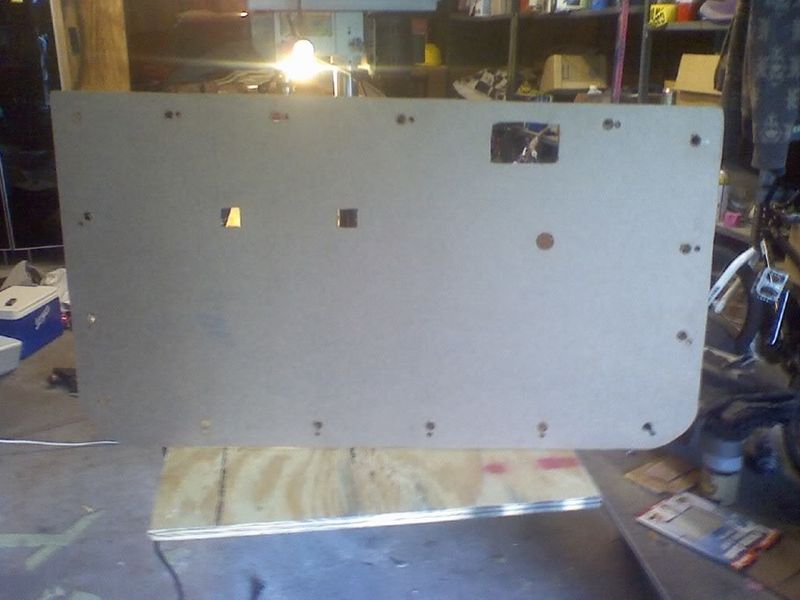

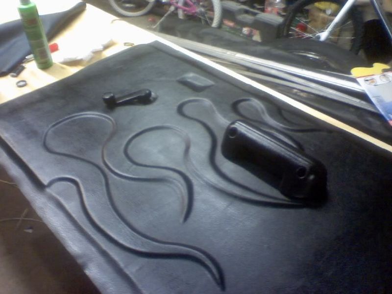

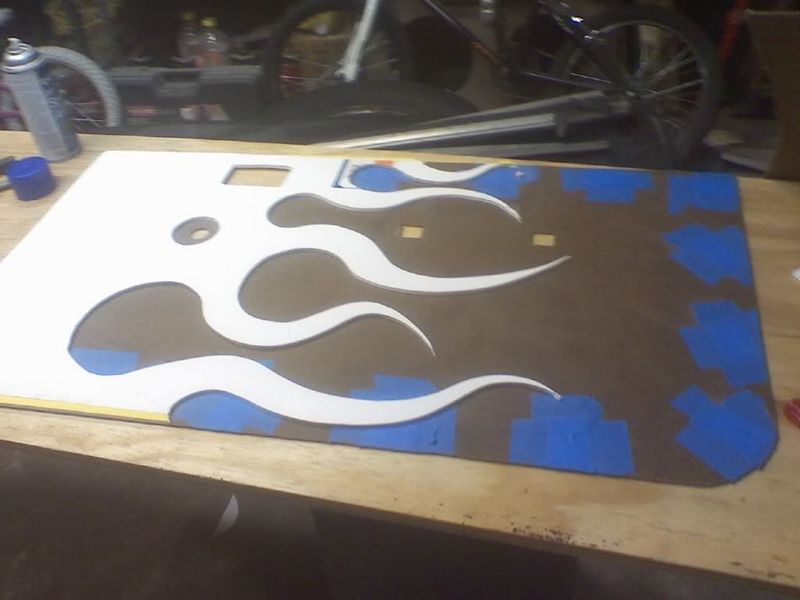

Thanks guys... The wood is 1/8" hardboard (masonite)... The flames are made out of foam board (from a craft store) and some cheap leather from a fabric store, a little leather product and it shines up very nicley and 2 cans of spray adhesive... it only cost me about 18 dollers and 3 hours to make both doors
minituckin
The adhesive i used is called "duro spray adhesive" its in a blue arosol can, bought it at Lowes

those panels look nice ,i recomend using dap weldwood glue ,from yourautotrim ,it holds under extreme heat ,ive used tons of local store stuff and after a couple months the moisture lifts the material ,but depends on some applications and materials too
