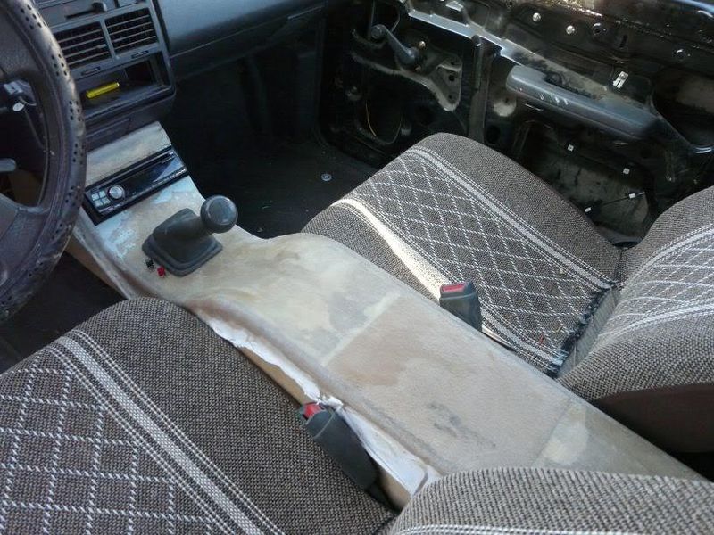

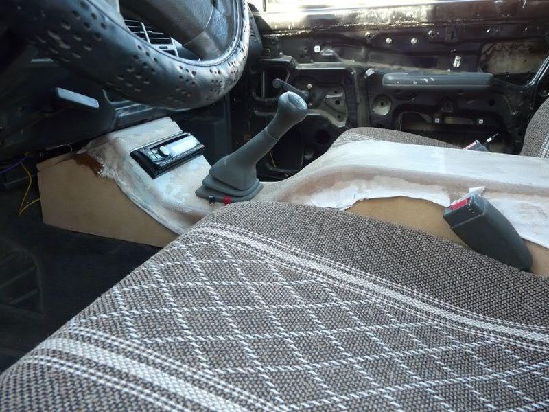

Ok be nice, This is my first time posting something i have made, its by far from finished i have to glass the outside after i get rid of the excess cloth and staples. lmk what you guys think. thanks

Heck ya. Are you going to paint it or wrap it when your done? I can respect the work that goes into making your own center console (I am in the process of making one too). But I didn't have the pacients to attack it with glass. But looks like a nicely executed piece.

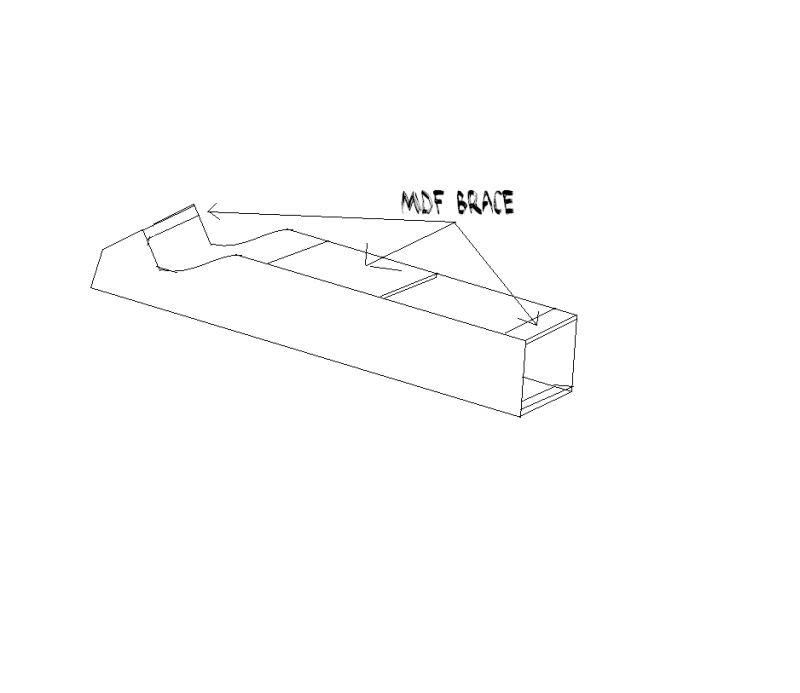

looks good ,ill give you an idea that will help the keep it structurally strong ,and make finsih work alot easier on the side pieces run a 1/8th groove about 1 inch from top of edges and staple it into that groove so when your ready to wrap ,the hardened fleece or material isnt sticking out ,and you can just lay foam over it and wrap ,and call it a day same for if you mudd and and paint it or you can take 1/8th inch hardboard and make same contour deisgn and lay on sides ,if you wanna paint top and keep sides to match material in vehicle ,hope that helps a lil
dncr8203
thanks for the idea. never thought about doing that. Ive got some ambitious ideas so all the tips and tricks help. thanks

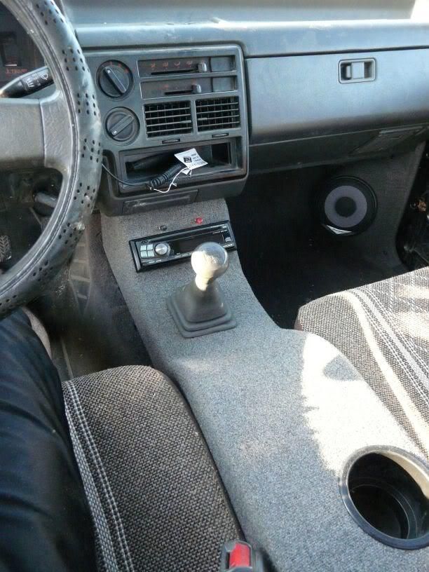

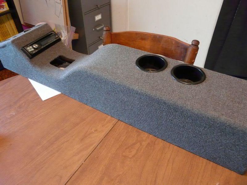

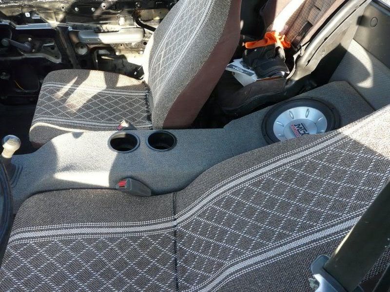

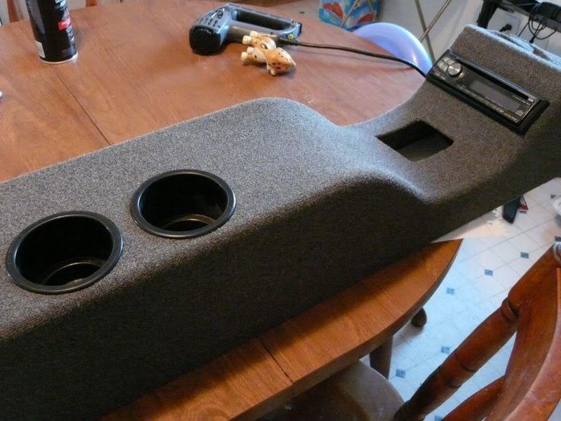

so heres my update to my project.
Its a charcoal gray tweed....it matches the plastic thats in the interior pretty well. even though most of it will get covered it works. Let me know what you guys think.
farfegnugen's avatar
farfegnugen
That is awesome! makes me want one!
sosatheshark's avatar
sosatheshark
very nice ,and clean looking

can you get a picture from underneith? I want to make one but I'm not sure how to go about the framing.
elbine69's avatar
elbine69
That looks nice, good job.
