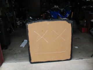

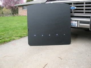

For those of you that don't want to keep the rag top look in there truck here is a couple of pic of what i have been working on, hope you enjoy any questions let me know.
Things you will need
1/8" panel board kind of stuff you would use on the door panels
tape measure
Skill saw
Jig saw
Ok first measure out a rough dimension.
The front of the cab is kinda oblong squared so when you round the edges you will take off 3" to 4" for the final fit.
for the center section you will need to notch out the sides so you can mount the panel flush with the cab
then attach to the center beam with 4 screws and your done!

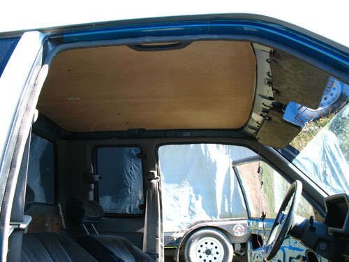

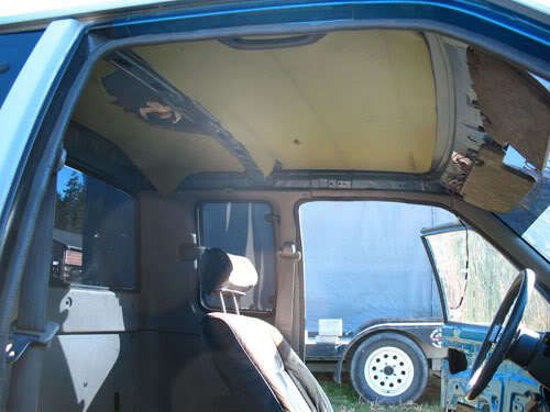

Ok this is what i started with

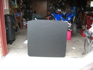

And then after some cutting and sanding this is what i looks like when im done!
