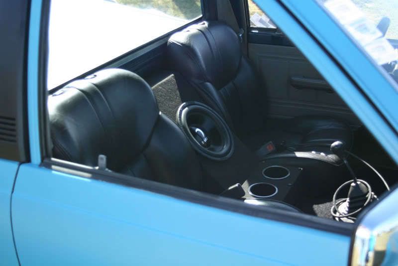

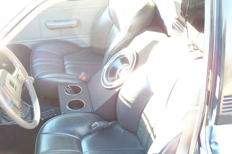

I had chrysler sebring leather buckets in my 88.The front mounts worked but the rears had to be drilled and bolted in.

damn melon those seats looks nice and comfy as hell tucked in there. those are sweet as hell. i want some leather as well. lol
