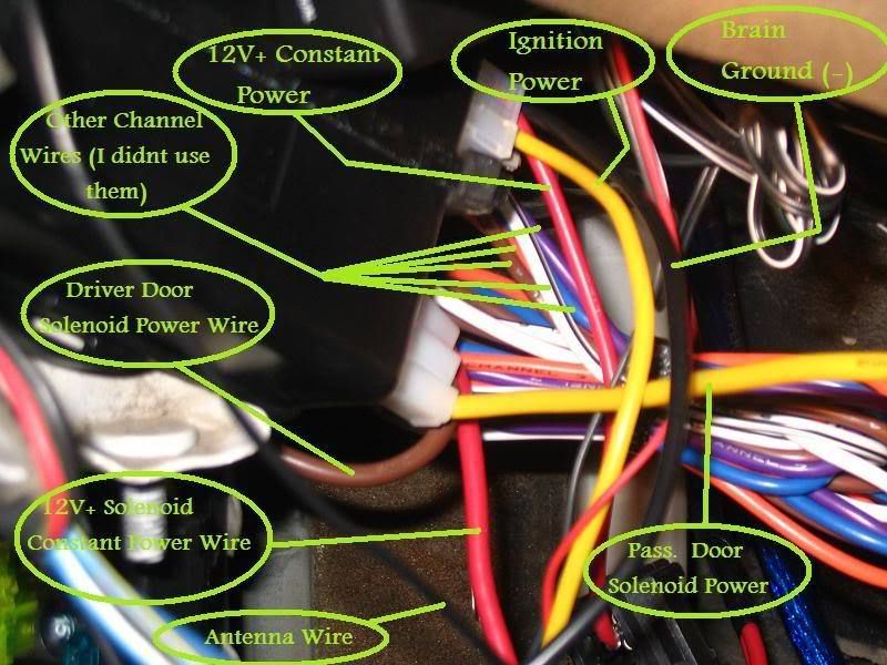

for the brain to power jus the solenoids you should have a 12v power wire, a ground, an ignition power wire (to disable the doors while the ignition is on) and the wires goin to each solenoid. And i'm in a very helpful mood right now so i'm gonna go pull my dash apart and my door panel off jus for you! BRB man!...... if you even get back on tonight haha

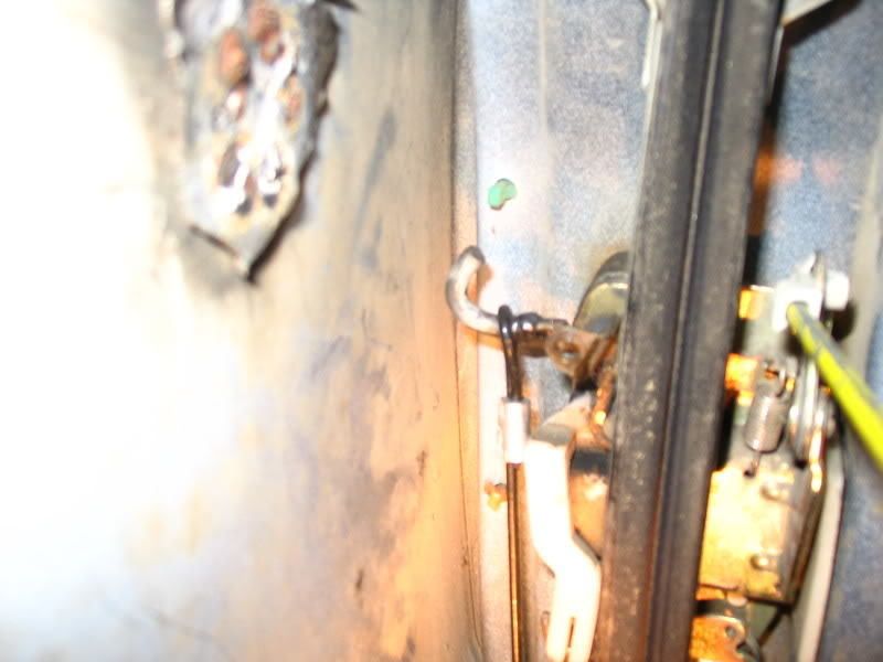

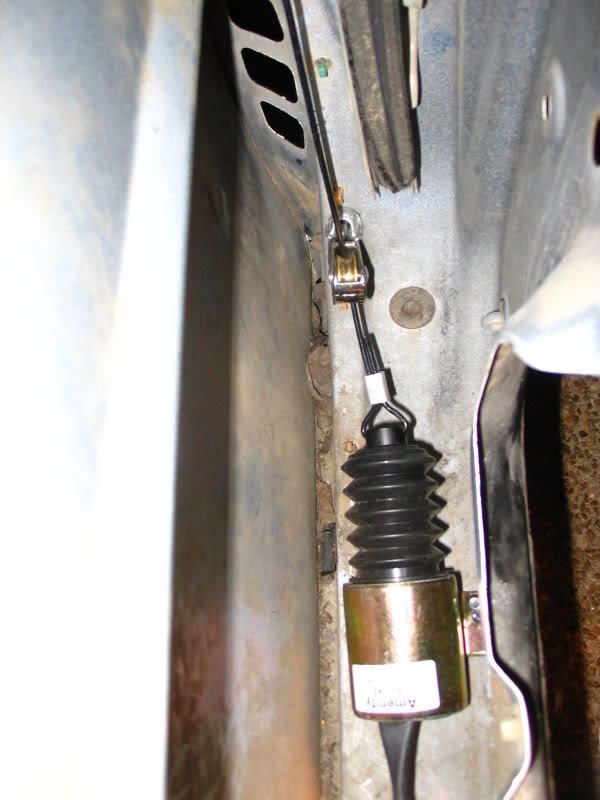

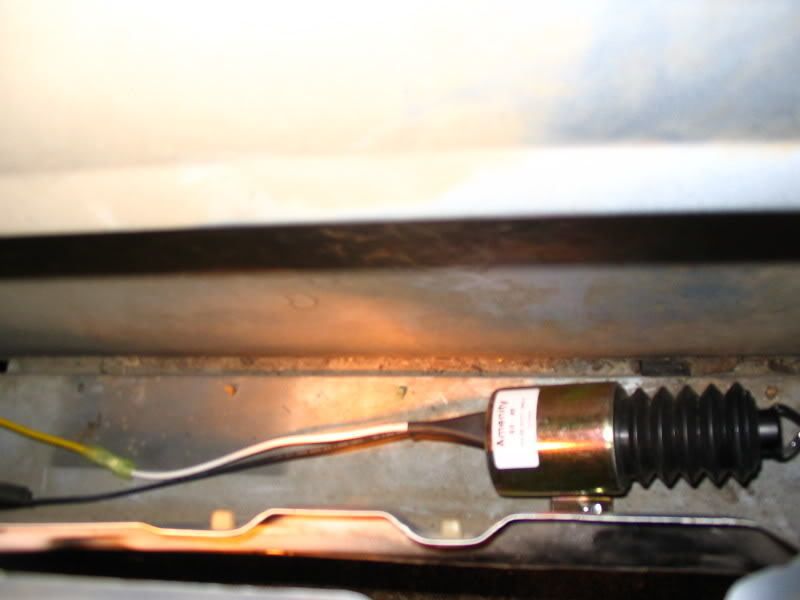

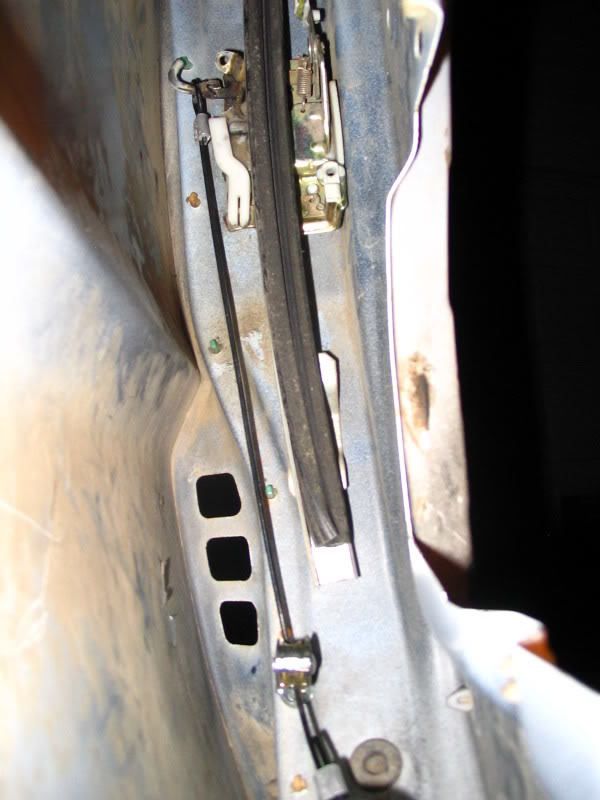

Ok... I didnt know how you had your solenoids mounted so i took a pic of mine, it works flawlessly......
This is an SPAL kit from eBay
bodied b2600zx (josh)
And you know to not ground the solenoid to the door right??? The door is NOT a sufficient ground source. You are jus askin for problems or possible fire if you ground it to the door

i like the pulley setup. I don't have the ignition wire ran on my setup, and I'm glad, Made a big mistake one night got out w/ the truck running, and left the windows up when I shut the door.
