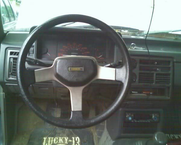

When my back is all better, and I'm able to go work on the truck again, I would like to put in a different steering wheel. One that has more style. I I really like the factory steering wheel that's in my cavalier. Would a stock GM wheel fit? What other aftermarket wheels fit?
This is the style that's in my cavy.
bodied b2600zx (josh)
It def won't bolt up. Maybe an installation kit available??? You'd have to check ebay or somethin
