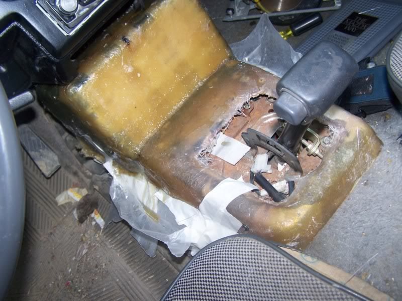

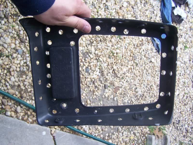

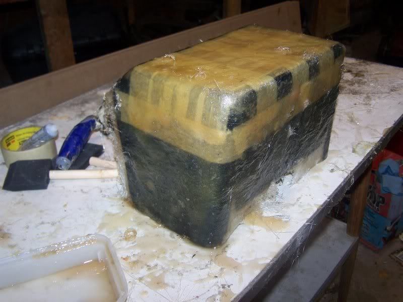

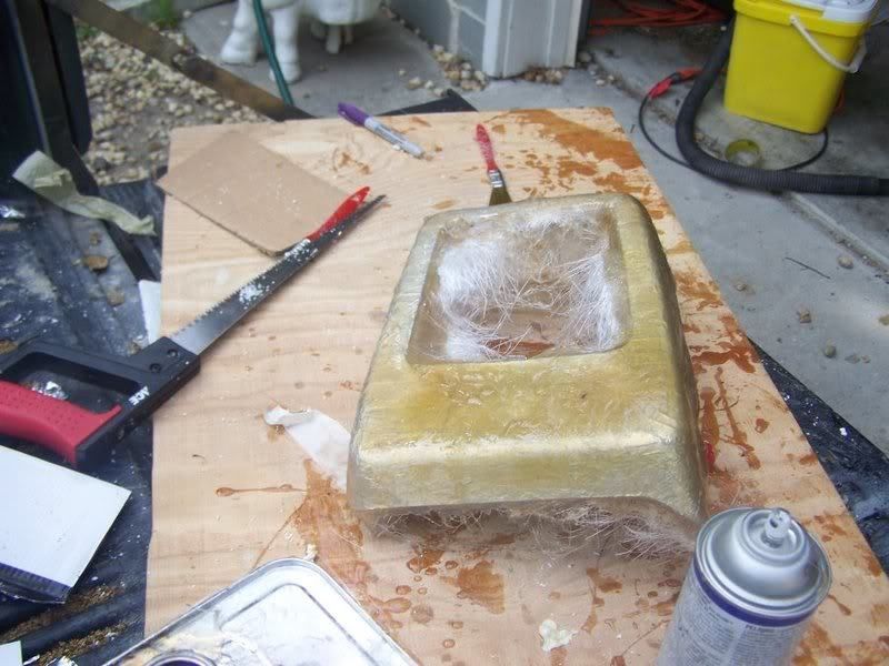

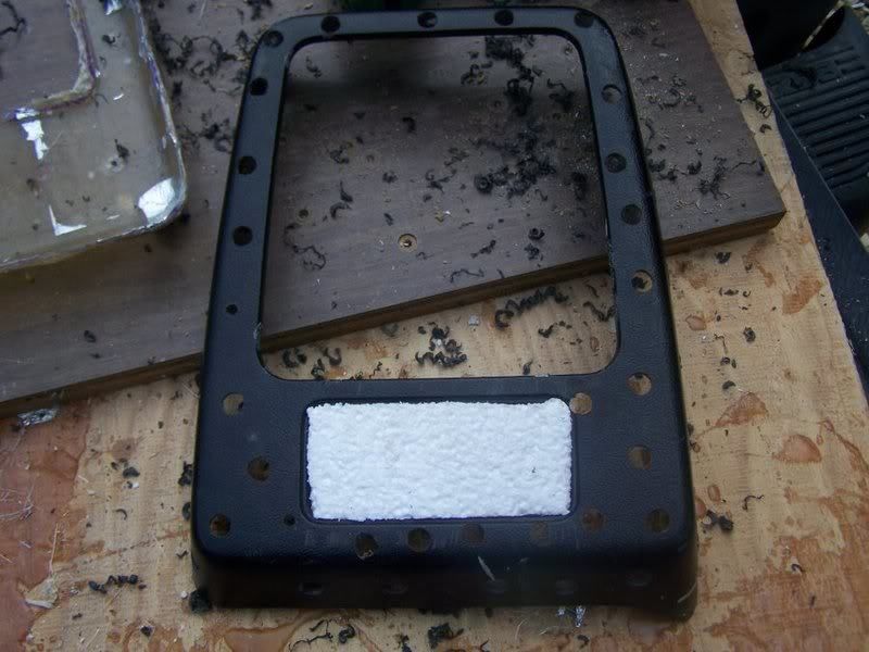

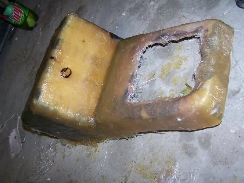

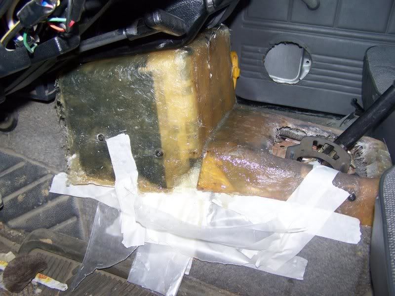

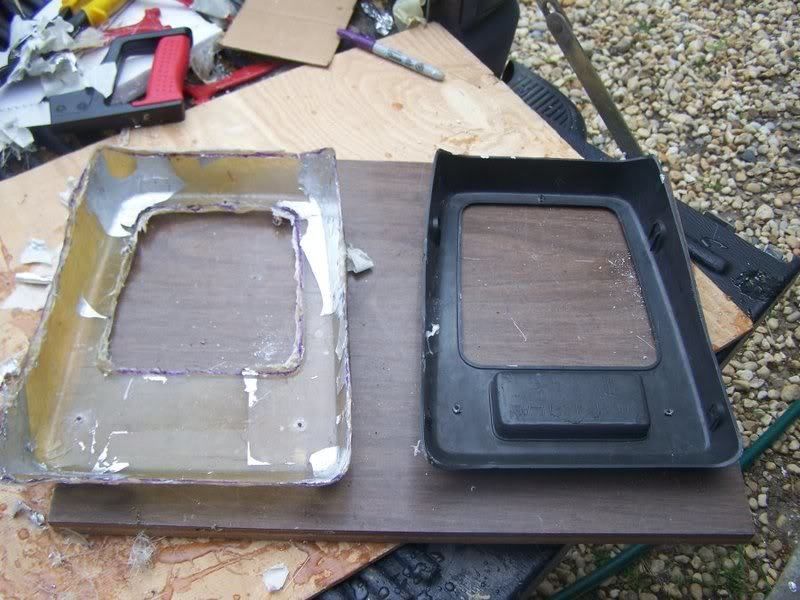

since my truck is my daily driver ive had to put the front bumper on hold till i have plenty of time to mess with it. meanwhile i took the stock console pieces out and started my build. in case anyone ask, i moved the radio up under the ac controls. the plan, make the whole console in one piece. the spot where the radio use to be will be for future dvd player or guages. the back (after the shifter) will curve up for the arm rest (level with the door arm rest) and then curve up a little more to join into the future sub box. the glass is layed with chop mat. the stock plastic pieces will be staying, i am using all stock mounts. the excess glass has not been chopped off yet (around the edges and open spot for the shifter)... more coming soon. need to pick up more sand paper.

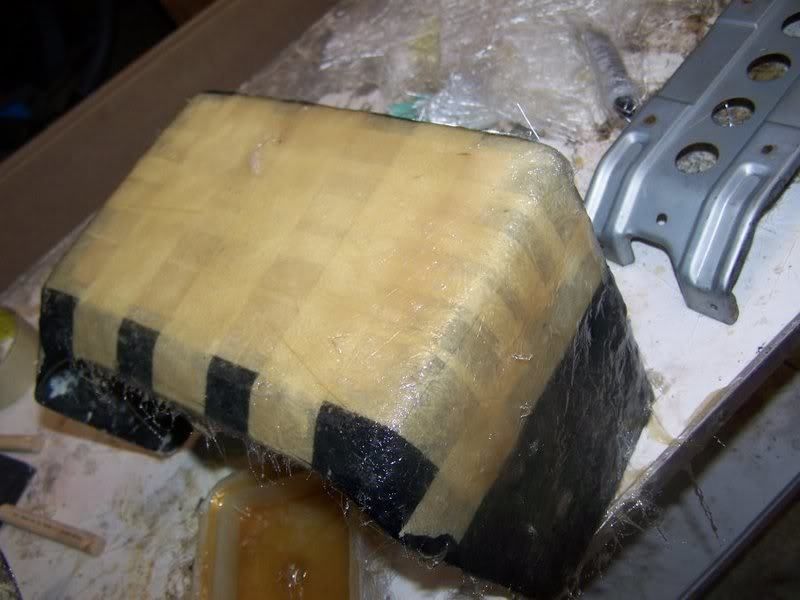

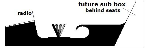

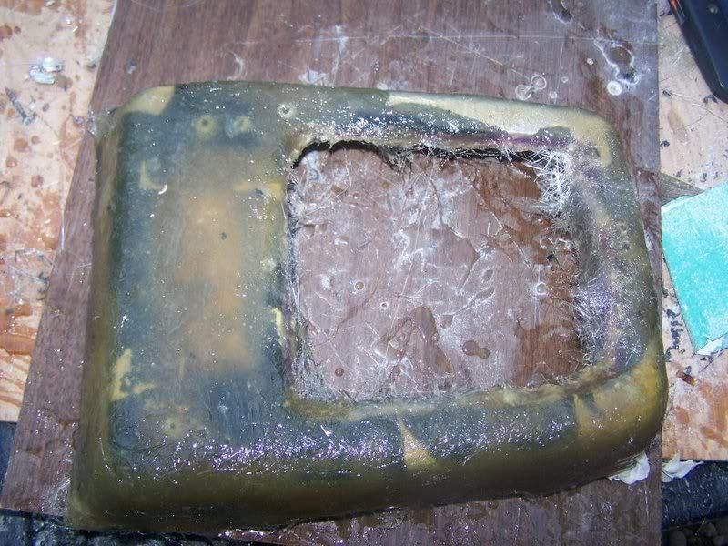

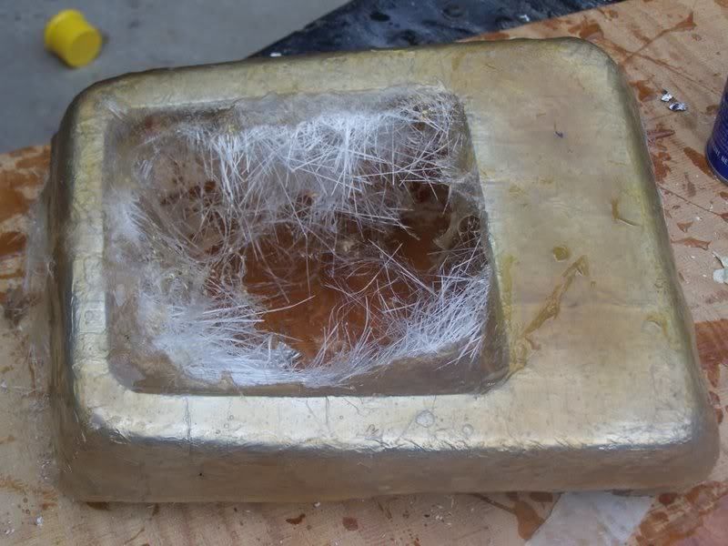

been broke. just got more chopmat and glass today. i did manage to start making part of the arm rest. ill post pics later

looks good what are you doing to the arm rest? cant wait to see the finished products..
NR
night rider

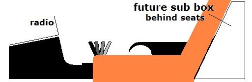

NOT TO SCALE.
i do want the top of the arm rest to be kinda level with the stock door arm rest
