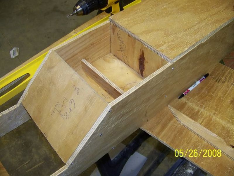

thanks to airedout89 i used his blueprints to mock up a console for my mazda. it took me a minute to realize his is a cabplus where as i just have a regular cab. one think i will admit is i hate carpentry!!! i even passed wood shop with a 3.5 average but this is drivin me nuts. i got it started and the shapes laid out. just gonna modify his design a lil bit and hopefully it'll work out great.
glad i got lots of extra plywood i'll git some pictures up here in a bit.

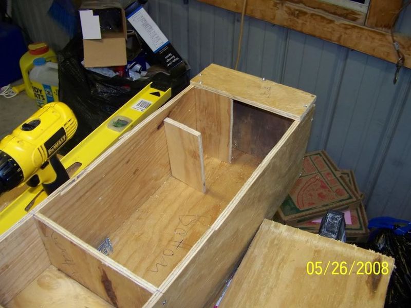

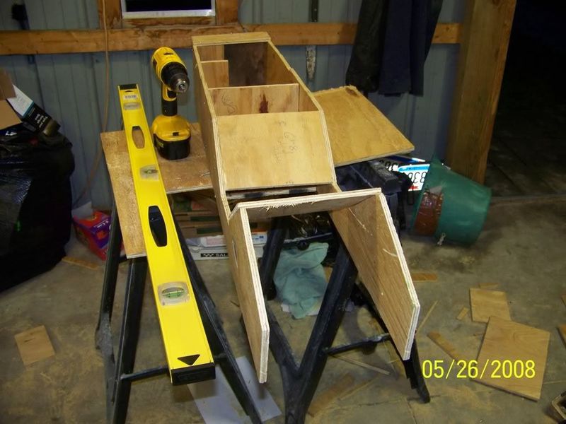

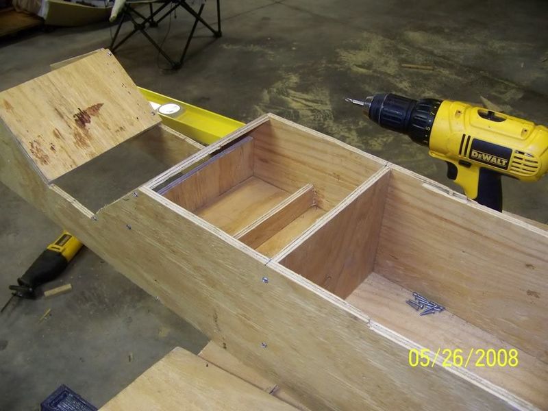

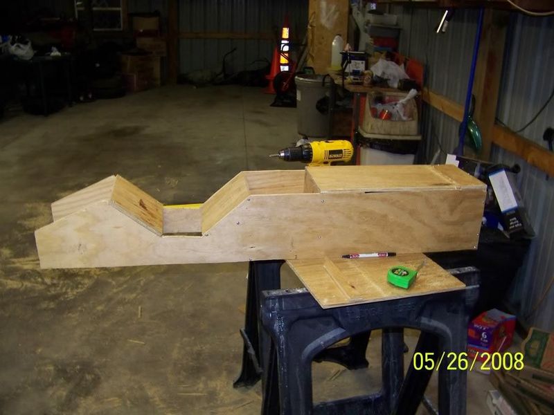

PICS PICS PICS!!! ain't finished yet but its bout done bein built. gotta drill some holes for cupholders and the girlfriends 'toy holders' i thought she was jokin...
hope i dont fugg up too much more. im runnin outta plywood!

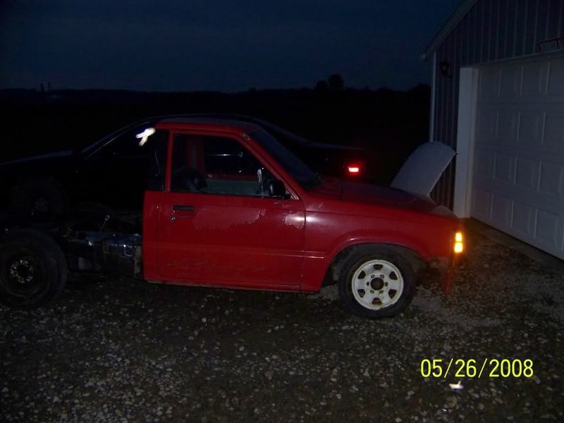

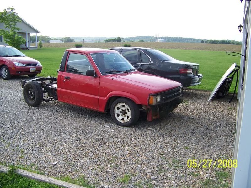

and here's the trucks stance now. gotta wait till i git some money to git the rims machined and the tires.

Lookin good. Maybe get some oil pressure & amp gauges to put in the blank area? An EQ?
Also, go to Home Depot and pick up a couple 3" PVC pipe couplers, trim out the stop ring in the middle, epoxy or fiberglass a lexan bottom and you instantly have some awesome deep cup holders. It will hold cans & bottles so they don't wind up on the floor. Thats what I am building for my Son's 72 Nova, the Exploder console had 2 shitty cup holders that every time I stopped it went on the floor...NO MORE

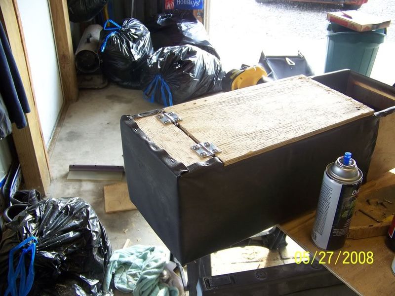

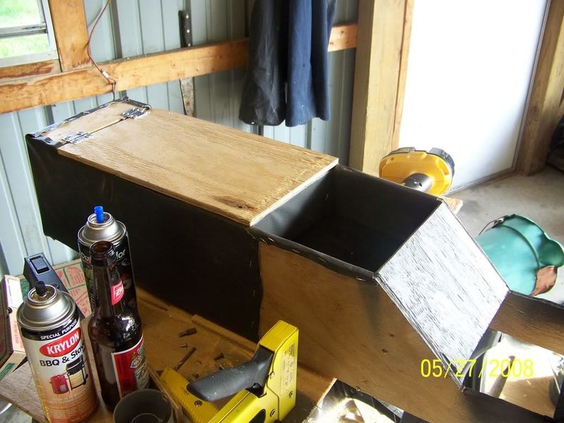

awesome! just need to git a hole saw from the neighbor tomorrow. probly gonna use grey vynil and put some pad on top of the lid. maybe carpet down the sides. ooooooh classy!
