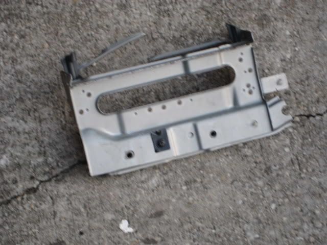

Cut the bracing out. Use an Air saw. After that, the air duct for the A/C needs to be trimmed as well. If you don't have A/C you can just remove the duct like I did.

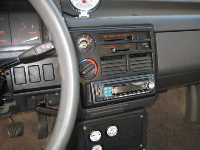

i put mine in the dash

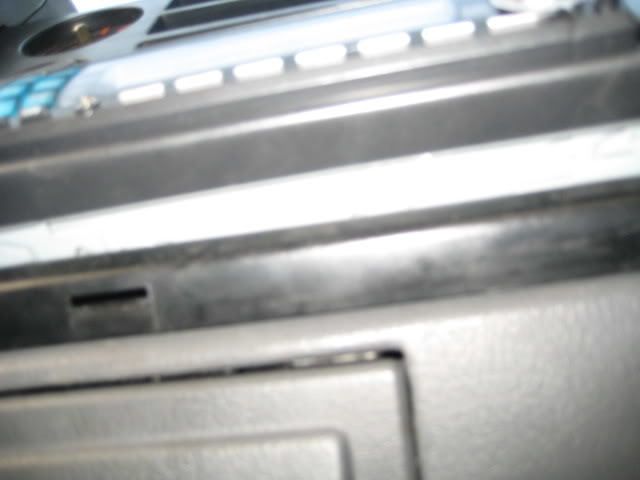

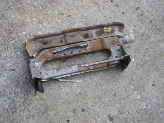

i cut this out:
i didnt cut the a/c ducting so it sticks out this much:

wow. now that i know whats goin on in the dash i can put mine up there too. i never liked it down low, specially with a 5spd. now i just gotta figure out what to put in the panel on my console.
bigmike
I did my stereo placement swap based on your pics, cut the same piece of bracing out and the deck sits just like yours...out a little. I just got my Milwaukee Heatgun off eBay yesterday, so looks like I'll pull it apart and see if I can't get it to sit back in there a bit more. If I can't, then I can still live with where it is now, beats the hell out of the stock location
