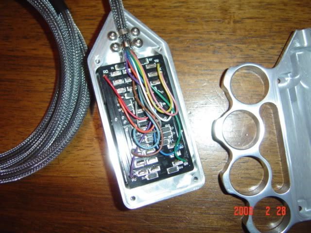

i need to do side to side and this isn't wired for it. how do i wire it? any ideas?

need a switch box with 9 switches...

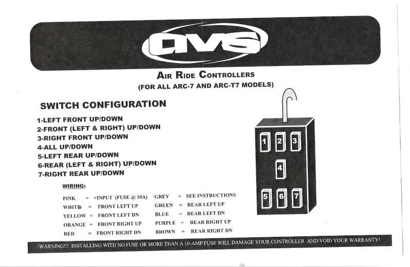

Glad to see that you got this thing...If you wanted side/side on lets say four switches ( 2 for left side up/down, 2 for right side up/down) I would wire it as follows:
Channel #1
White (Front Left Up)
Green (Rear Left Up)
Channel #3
Yellow (Front Left Down)
Blue (Rear Left Down)
Channel #5
Orange (Front Right Up)
Purple (Rear Right Up)
Channel #7
Red (Front Right Down)
Brown (Rear Right Down)
I am not sure if that would work, but thats the wire combo...
Channel #1 and #3 would be Left side Up/Down
Channel #5 and #7 would be Right side Up/Down
Dev
audioinmotioninc
YOU WILL NEED AN EXTRA SWITCH ( 12 PRONG CARLING SWITCH (LIKE HYDRO SWITCH)
THE COLOR ARE FROM THE WIRING DIAGRAM IN THE ORIGINAL POST
FLU - FRONT LEFT UP
FLD - FRONT LEFT DOWN
RLU - REAR LEFT UP
RLD - REAR LEFT DOWN
FRU - FRONT RIGHT UP
FRD - FRONT RIGHT DOWN
RRU - RIGHT REAR UP
RRD - RIGHT REAR DOWN
JUST LOOK AT THE COLORS AND GO FROM THERE... JUST BE SURE TO JUMP ALL THE PINKS TOGETHER IN A SERIES........OR ELSE IT WONT WORK RIGHT
HOPE THIS HELPS
