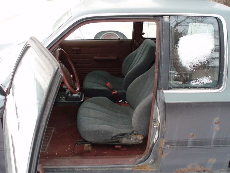

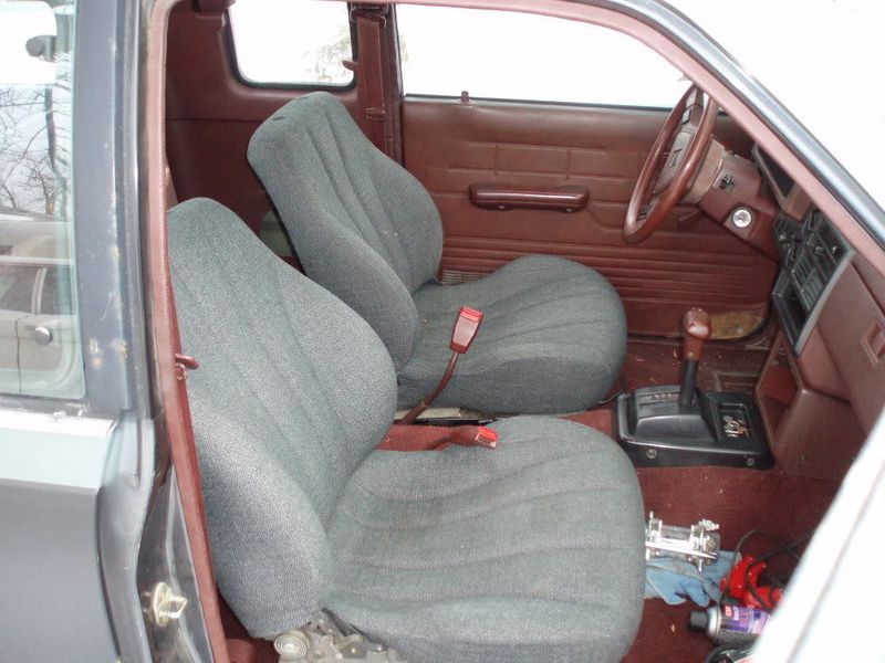

i put some sunfire buckets in one of my trucks and pulled off the headrests. took about an hour of fab work to get them to work. I'll take some pics and get them up here.

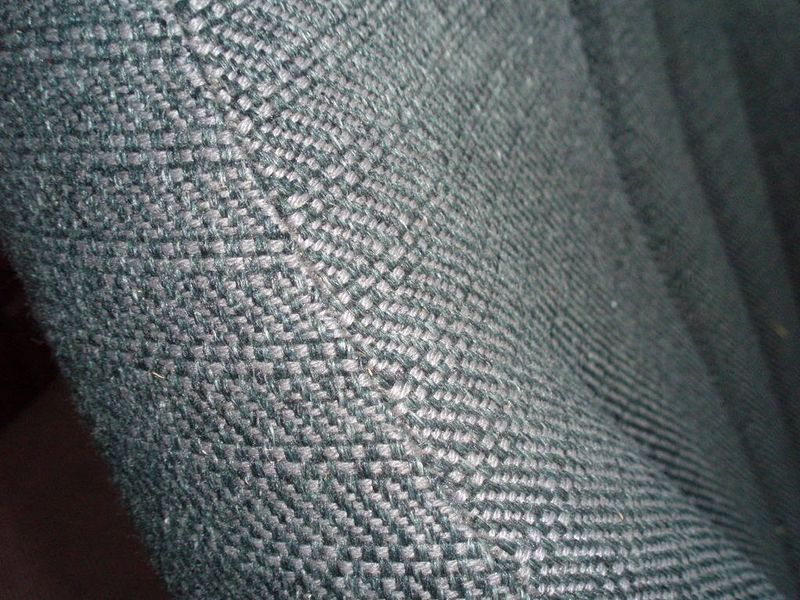

Of course they look better in a truck with grey interior,but they got a nice tweed fabric.
for the holes left by the headrests I just painted a couple of carriage bolts gun grey and stuck them in. As an added plus, they are pretty comfy
