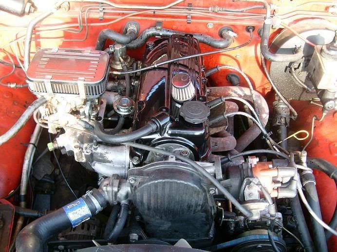

Do you have a pic of your engine bay after swap?
dropped90(justin)'s avatar
dropped90(justin)
there ya go man.
-justin

Niiccee..........
