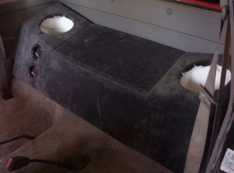

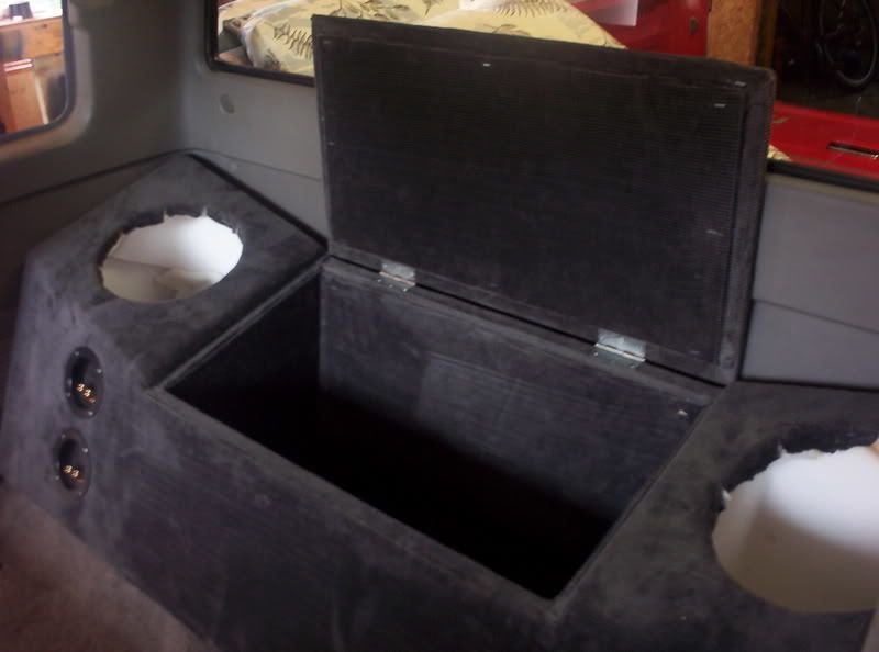

joshbrennan
this is what I did for 2 10's. keep in mind its the first time I've ever made anything like this.
I wanted to have some storage so i made a 'chest' type thing in the middle.

Lol, I like the chest idea!
