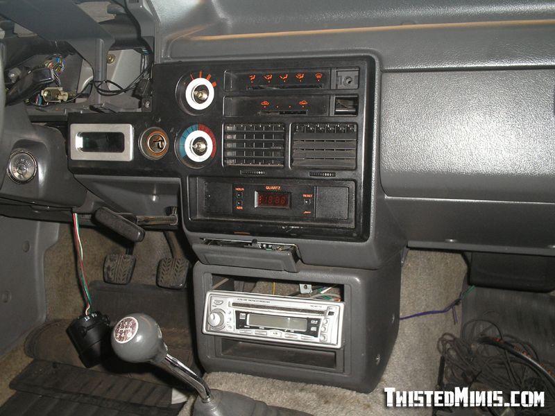

Okay I'm sure you guys know what a Mazda dash looks like. Lol. I've got this digital air guage that the owner wants installed, and I'm not really seeing a good place for it. And a few of the panels were removed and not given to me, so its kind of hard to figure out.
Size wise its about 1.5" tall and 3" wide, maybe 4" at the most.

3 switch pods - below the right hand side of the guage cluster. if there is no switches in there mount it there !!

Yeah theres not really anything there. How do you remove that panel?
deviousb2200
if its like mine there is an empty slot with the radio put it there.. or like He ^ said put it where the three empty pods are..

Heres a list of what you'll need to do.
1. Remove 4 screws from the gauge bezel. Two are in the top of the bezel directly above the gauge cluster and the other two are under it. Once those are off remove the dimmer switch plug.
2. Remove the 2 heater control knobs. Theres two nuts behind them.
3. Remove the 2 plastic cover panels on the top right side of the heater controls to reveal philips screws.
4. Theres also a screw on the upper left side of the panel that was hidden by the gauge bezel.
Then if I'm rembering everything it should come right off.

I'll go try it, thanks.

I think it looks pretty decent.
deviousb2200
are you gonna be able to see it good right there?? I was thinkin about that little hole right there under your radio.. Is it big enough?? I think it is gonna look real good right there though.
twisted minis's avatar
twisted minis
Well, I can kind of see it, the steering wheel blocks it a little bit. But the guy that owns the truck is like a foot shorter than me, so I had my little brother look and he can see it fine.
And I think I would have had to make some kind of panel to fit it near the CD player (which is just sitting there....) and I was not given permission to mess with that area.

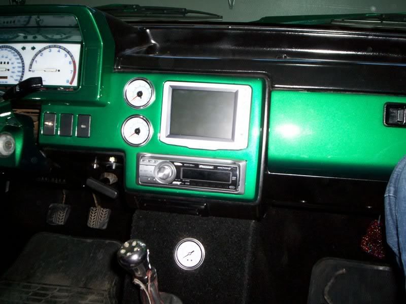

heres mine seth a little more work but u can see it better
