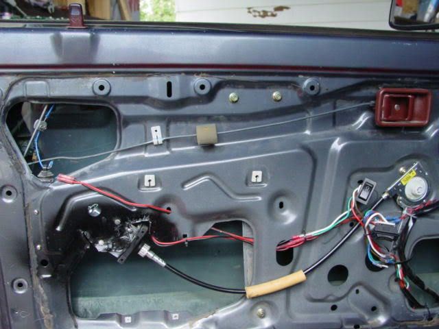

mazdamandan's avatar
mazdamandan
I have custom power windows, I dont know what to say other than ya buy the kit and do the best job ya can, I 'll tyr to help If ya have any Qs
mazdamandan
got power locks w/keyless entry too, most 12v stores can order this stuff.
Window kit 300.00
having one of the only Mazda Bs w power windows............ priceless
I took my time, it may have been 5 hrs total install time?
