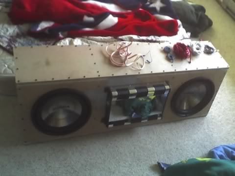

here is my setup...
which is 2x12" Insignias and an insignia amplifier
the setup IS for sale, 175 bucks...
