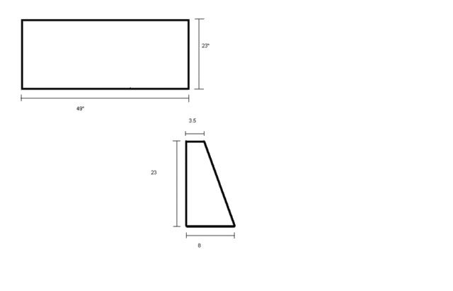

ok heres my dementions...im not wantin to run over 600 wts. what would yall suggest?

that looks great... just compensate for the usless hump in the rear of the cab and make a mach-up makesure it fits comfortably... how much volume do you need in the box?

what sub, how many cubic feet u need?

Id run 1 10 in a ported box. That will give you the most output for the area you have to work with and the power you want to run.

I'd go with a 10. I have a 10 with a 1cuft ported box making 500W RMS and it sounds good especialy if you extend the box to add a 6X9 on either side of the sub (in independant sections of the box of course)
