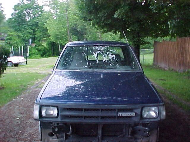

heres where the horn is. its right uder the pass. headlight, the lil ound thing. -bf
