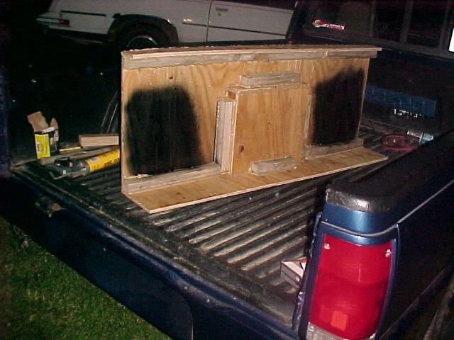

hey man you will find it aot easier than you think if you build your own plus you can get a better fit than a prefab. i plan to get a 10" l7 and leave it in a sealed box. if you have the tools build it. if you have any qs about building, just ask there are a few of us that can help ya out alot. also what amp are ya runnin? -bf

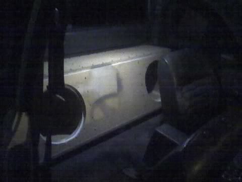

or like my mofo is right now. more pics if ya wantem man. -bf

i did a setup for 2 12's in my x cab... looked pretty nice...
i know its ex cab but my point is, you can build somethin to specs easier then you can buy one... more then likely it'll be cheaper too!

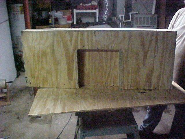

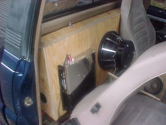

Question - do you mind cutting and welding? If not, an option is what I did. The big useless bump in the middle of the back wall was cut out, framed with 1.5" angle iron with a sheet of steel welded to the angle iron. The end result is basically a 1" outward bump in the back of the cab that is the exact size of the sub box. This also allowed for the large magnet size of the Fosgate Punch 10" sub mounted behind/between the bucket seats with the magnet IN the box. My box was .65 cu.ft. If you need .88 cu.ft it should not be that hard to get the extra space. This setup also left a fair amount of room behind both seats for ???? Can post a pic if needed.

Pic of back wall after cut out and metal installed.
Exterior shot with metal pokin thru. New sheet metal is attached to that metal strip along the back of the cab.
And finally, a pic of the sub box installed. Will eventually be candy green like the rest of the dash (See Immortal progress pics in Photo Post)
