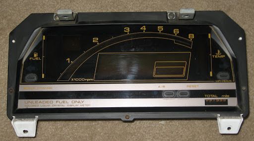

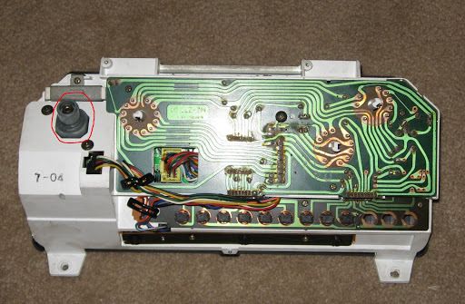

well i finnally got around to taking that guage cluster out and it does have a cable just like our trucks...so using the guage cluster wouldn't be a problem except for the wiring which shouldnt be hard because i have the whole car!! The plugs on the digital dash are round and i could just cut them off and splice it into mine...and about the dash...the dash is exactly 54 1/4" and our truck's dash is 53 1/4"....but our trucks are 55 1/2 from door to door so fitting this dash should be to hard ! i took some pics of the guage cluster so i could post them to let yall see what it looks like...i have never posted a pic so i will see if i can get them posted
