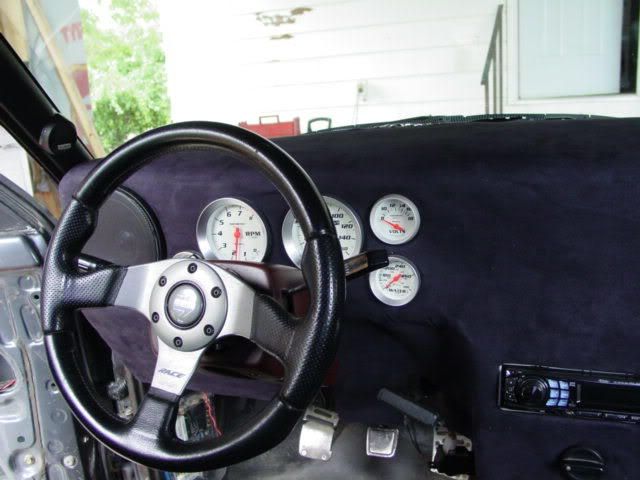

mazdamandan
all of my guages work!
hand made sheetmetal w micro fiber dash.
